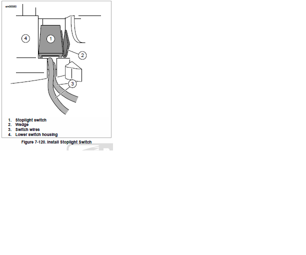

The button switch for the front brake is moving freely in the switch housing. There is space between the back of the switch, it seems like a spacer is supposed to be there to fill in the void. It must have come out when I did my handlebars, but I need to know what I am looking for.
Old Jul 20, 2016 | 05:58 AM
14GuineaPig's Avatar
14GuineaPig
Joined: Sep 2013
Posts: 3,492
Likes: 610
Item # 10 is a metal wedge that goes between the switch housing and the back side of the brake switch.
http://www.outpostalaska.com/OEMpart...eSWITCHES%5cBX
The picture is from a 1998 Sporty Service Manual

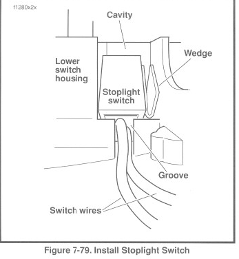

Old Jul 20, 2016 | 06:10 AM
14GuineaPig
Joined: Sep 2013
Posts: 3,492
Likes: 610
From the 2009 Touring Service Manual
