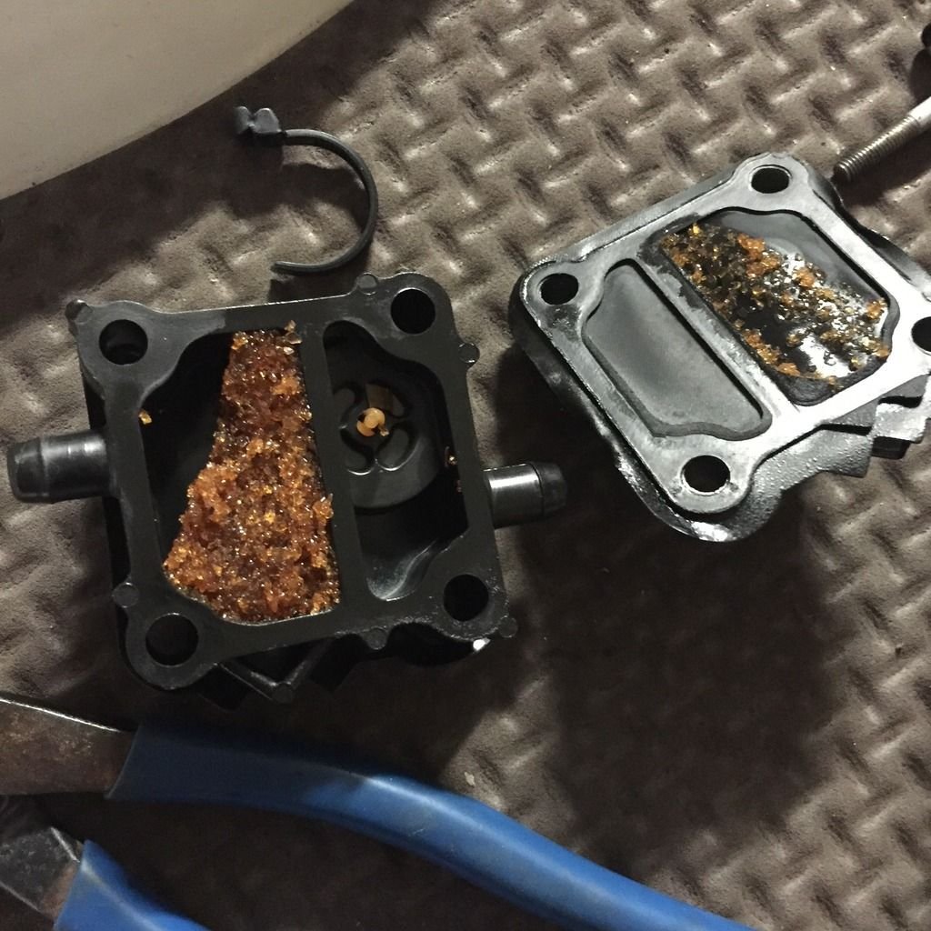

This pic, borrowed from earlier in this thread from RacerKVN,
Shows the polymer that forms from some of the dregs out of the bottom end of an Ethylene plant. The stabilizer has a killer for the reaction that makes this stuff form out of the chemicals in the dregs. I used it for years in a "dregs" unit in Dow, in the Butadiene plant. It works like magic in microscopic amounts. Keep it in there. It is great for preventing that from happening.

Okay, thanks. But I musta missed that photo. Curious about some of the terms you used for identifying these compounds ie; "dregs" "polymer"... By dregs, you must be referring to the strands wrapped around the kernels in corn? And the polymer is what develops in what part of the engine due to the chemical decomposition of ethanol?
Please explain... First I've heard of this and yes! If I plan on leaving a motor parked for any length of time, like yard equipment for instance, I add fuel stabilizers always.
This residue is from the gasoline component of the fuel deteriorating, not the ethanol. Ethanol itself is quite stable. For instance, you won't notice stuff like that appearing in old bottles of booze.
In fact, I happen to have 25-year-old containers of ethanol (purchased for industrial use) which are still perfectly clear, with zero debris. And when this alcohol evaporates, it doesn't leave any gum or varnish, like gasoline does.
"Longplay" mentioned that the dregs came from an ethylene plant, not an ethanol plant. These are two very different things, with most ethylene coming from the refining of petrochemicals.
By "dregs" I mean the chemical plant refines the raw product and takes out the parts that are not the chemical that they want. Those unwanted parts are "dregs". In the case of our gasoline, they are components that boil out of the stills, or distillation vessels, as heavy components around the boiling point of our gasoline. So, since they are unwanted, they pipe them out to the gasoline blending station area in the back of the refinery. They are very reactive when exposed to air, and form polymers when in contact with oxygen. Similar to the "gel" that forms in old diesel. But in the case of these chemicals, it does not stop at the gel stage, but goes on to a polymer very similar to the rubber that is of a similar color, that you see on the soles of some work boots.
I could give you all the chemical names, but this is already boring enough for this forum. I deal with these things daily, and have been working in the Ethylene and refining side of things for almost 45 years.
And, by the way, once that polymer is formed, it is not really very soluble in anything I can expect you to find. So the only fix is to disassemble and clean. A flush with some solvent is not going to help once it has formed up into beads like that.
Yes, and the ethanol has very little if anything to do with this fouling. But they are right, the ethanol has a slightly lower BTU content on burning in our cylinders than regular gasoline. But I would tell you, it is probably less than the 3 to 4 percent values I hear people talking about. It is hardly noticeable actually.
OK, sorry to get technical on this, but I do not know any other way to explain it.

So what should I do with this? Junk it? LMAO
