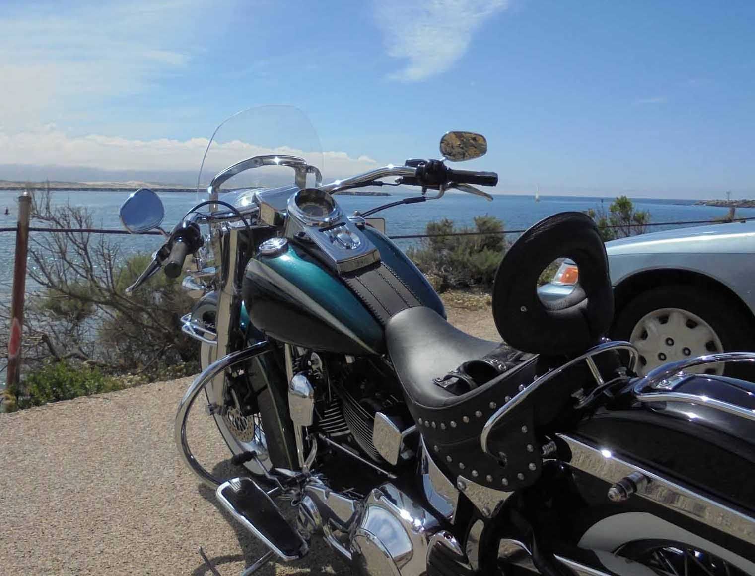

Cut down Nostalgia windscreen. I had a problem with severe head buffeting with a 16", annoying head buffeting with an 18', and I hated looking through the billboard 20". I tried lower deflectors, but that didn't work.
So, I cut one down to about 10". I started with cutting 4" off, then a little more and a little more. Trimmed some off the sides and then tapered the top to end up with this height. This cut enough wind pressure to my mid section, and puts my head in clean air.

What did you cut it down with?

I put masking tape over the whole surface and using a cardboard template, drew the cut lines with a sharpie. I used an abrasive cut off wheel on my angle grinder to make the cuts, then a sanding disc to refine and smooth the edge.

That's an idea since I already have one. just WAY too big for my liking.
