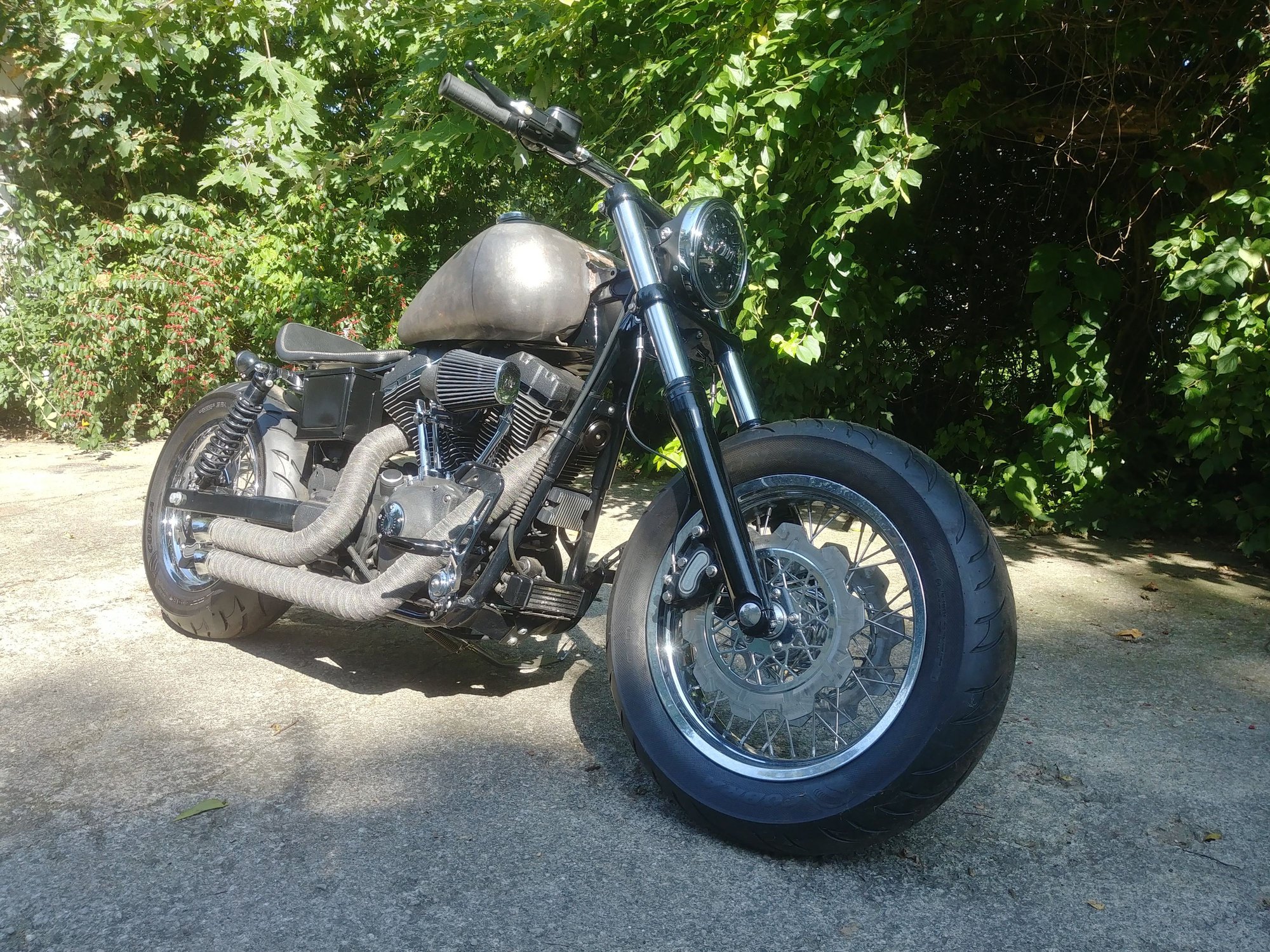

Thanks Kinect! This thread helped me. I went a slightly different route but I did use the Sniper II system and the goal was clean(er) bars. Fairly pleased with the project and thrilled with the Goodridge. I'm away from home and the bike is in storage for the season anyway, but here is what I have...
Sniper II lines and fittings with Goodridge banjo switch, stock lever perches, Delt Fab LED levers, Posh internal throttle, Carlini Lowdown bars, Motogadget mini switches, & custom transition/trim rings.
Sorry this is the best I have. I can get something better if anybody is interested.
Those mini-switches are cool! I thought of getting something like those but my bike is a Canbus system so additional module and cost is needed which i tried to sway away from. Good job and i appreciate the feedback.
