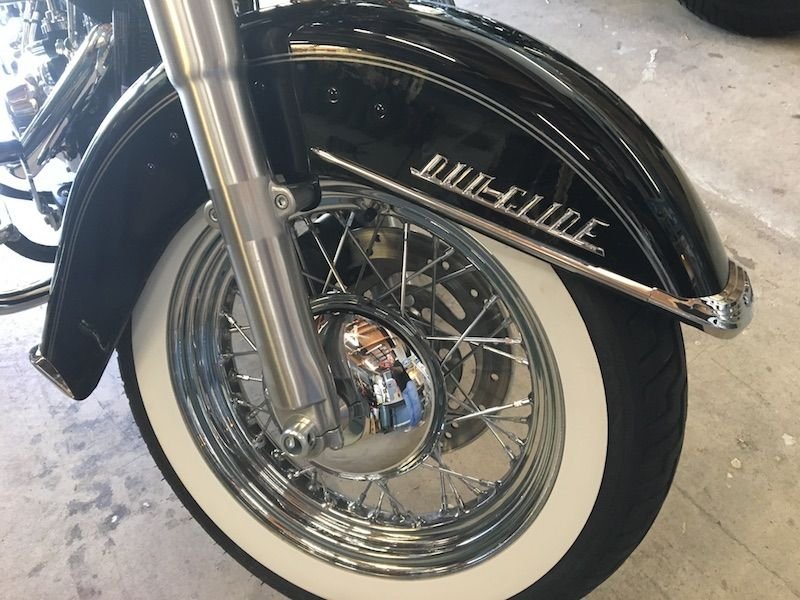

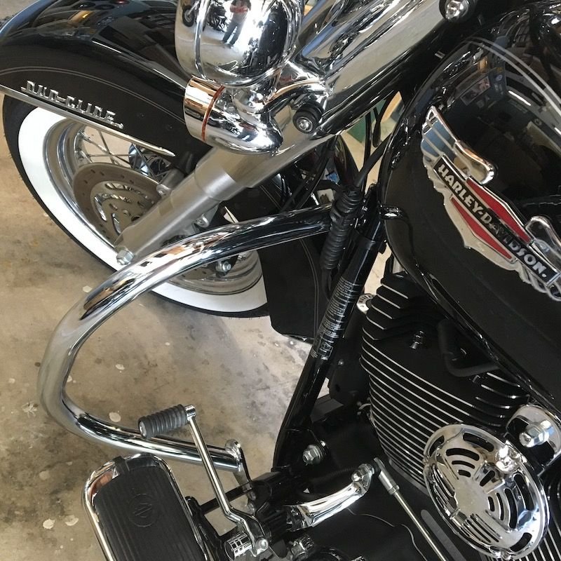

Okay gang. Well, I received the new fender badges in the mail today. I bought the ones from V-twin and I have to say, I'm more impressed with the quality of these badges than I thought I'd be.
And, just like schlacker said...
Originally Posted by schlacker
Those 3 studs didn't match up. However 2 of them did. Sort of. I had to elongate one of the holes with a Dremel just a tad to get a snug fit. The 3rd hold I filled with RTV for the heck of it. The emblem completely obscured the empty hole anyway.
And, that's just how it went down. Easy peasy. The only exception is that I used a small round file instead of the Dremel. I also used the Dremel with a cutoff wheel to remove the center stud from the emblem and used my shop sanded to clean up where I hacked off the pin.
Then I painted the holes with vivid black touchup so they're less likely to rust.
I'm very pleased with the way the fender turned out with the new badges in place. A huge shout out and THANKS to everyone for your help!!!
