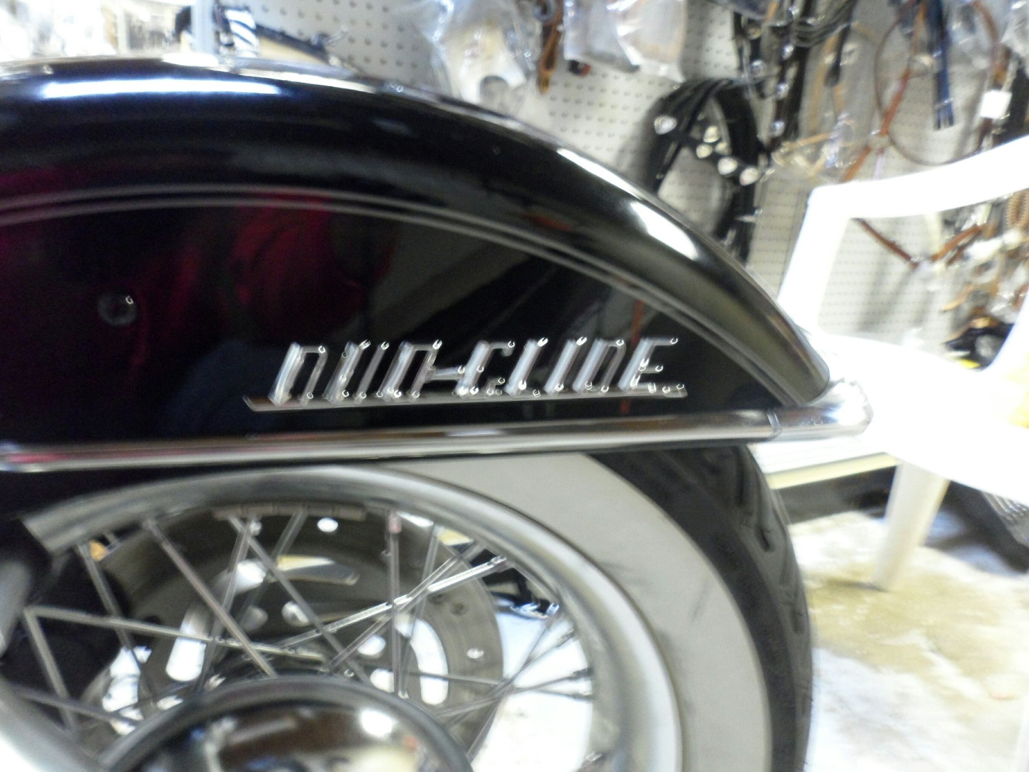

In case anyone is interested, after a whole lot of digging around in the softail forum, I found this gem that answered my question directly. Maybe this can help someone else with the same question.
Originally Posted by schlacker
I have duo glide emblems & those 3 studs didn't match up either. However 2 of them did. Sort of. I had to elongate one of the holes with a Dremel just a tad to get a snug fit. The 3rd hold I filled with RTV for the heck of it. The emblem completely obscured the empty hole anyway.
Here's the pic schlacker attached to the original post:
Sorry I didn't come across your post earlier & save that digging around on the forum.
I'm curious if the new Deluxe emblems on the '16 & '17 models will fit the older models like mine? I kind of like them.

Originally Posted by cocky
But it ain't a duo glide?
No it's not, but I wanted to use the tank & fender emblems that Harley was using in 1958-the year of my birth.
