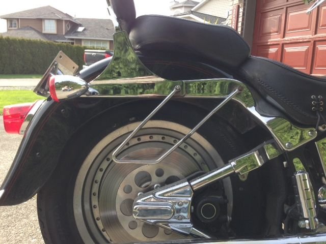

If the tire is tucked pretty far up in the fender then more than likely it's slammed with no rebound. You can adjust them with ease but I'd suggest either some air ride or progressive shocks. Also look at the shocks and if there is a lot of thread showing it means it's lowered. Remember on a softail that to "lower" the rear wheel means extending the shocks pushing the tire further up into the fender.

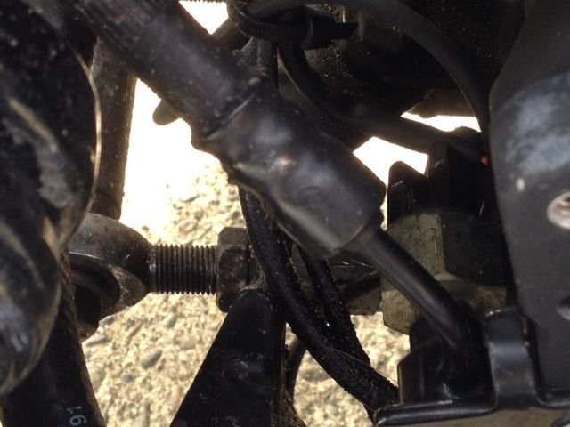

chrome-dome-dave
It would appear both the fender sitting lower and nearly an inch of thread exposed would confirm what you said regarding the suspension being lowered.
Not sure if the photos will show up here but regardless your insight is appreciated.

Dave
Based on your comments, it would appear that both the fender sits lower on the tire and the thread is nearly an inch exposed. Not sure if the photos will come through well on this but we'll see. Thanks much.
Thanks also QC, I'll definitely check out the web for these adjustments.

I'd say it's lowered. If you can afford it, throw those away and invest in some good quality shocks.

You can try to adjust the shocks on it to see if it helps. The lock nut is showing in the pic you posted. the more threads between the lock nut an an eye bolt the lower it's set. crank it in about half the way from where it is an lock it down.
