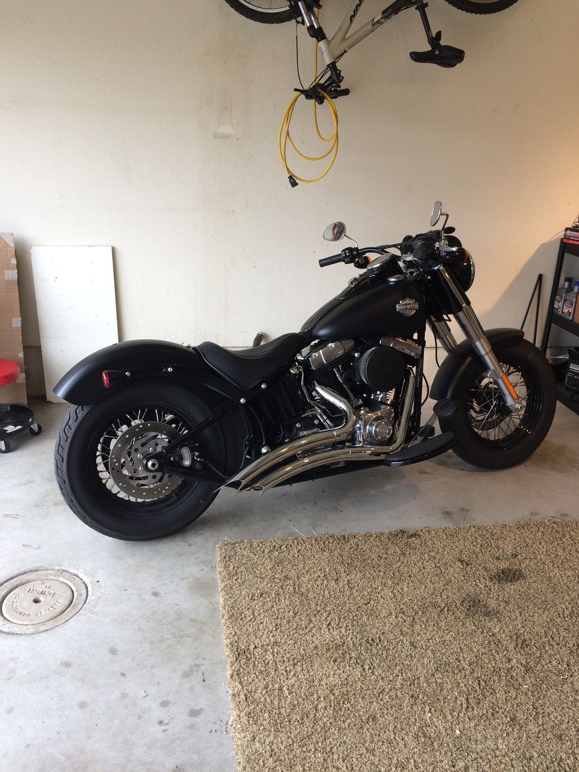

Thanks for allowing me to join the forum. I ride a 2016 slim. I was hoping you guys could help me out. I just installed new risers and went to start the bike and it's not starting. Lights come on, initial beep sounds, my power commander lights up and I can hear the fuel pump and that's it. Dash doesn't light up, no horn nothin! I originally thought my battery was weak, so it's been on the trickle charger now for a few hours. The battery is fine and I checked the main fuse and the three fuses in that block are ok. I removed the speedo dash and all the wiring under it seems to be okay. Any suggestions? It was running and starting fine before the riser instal. I didn't disconnect any wiring in in the process, yet it seems like something obvious must be going on. Any help would greatly be appreciated.
