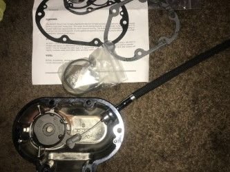

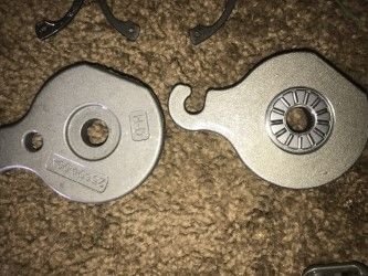

THE OIL SPREADER ON LEFT GETS TAKEN OUT?
ROLLERS SUPERIOR!
THE METALS, SUPERIOR, THE RAMP , INNER, STOCK HAD A LITTLE HOLE, BAKER DIDNT? SUBTLE DIFFERENCES IM POINTING OUT, ALSO THERES A LIL BRASS SPACER BEARING/WASHER IN THE THROWOUT BEARING ASSEMBLY, I LIKE THAT, NOT SAME METALS RUBBING ON EACH OTHER, I WILL CALL BAKER AND SEE, WHEN THAT PIECE NEEDS TO BE CHECKED/CHANGED..WHEN YOU HOLE PARTS IN HANDS YOU "FEEL" THE DIFFERENCE FROM WEIGHT, TO JUST BEING DAMM SOLID, NOW THE DOOR ABOVE, CONCEALS PICS ABOVE, AND WHOLE ASSEMBLY!!

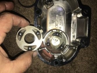

SO IN TALKING WITH BAKER THE ROCKER, WILL NOT LOOK LIKE PIC SHOWN WHEN YOIU TAKE OFF OIL SPINNING WHEEL, AND THERE WILL BE A TAD SIDE TO SIDE MOVEMENT, THATS FINE, AS WHEN ASSEMBLY ALL COMES TOGETHER, THAT WONT, AHPPEN, I MADE 3 CALLS TO VERIFY, I FEEL ITS MY OBLIGATION TO SHARE WITH COMMUNITY AS THIS IS A WELL NEEDED, GREAT, IN-EXPENSIVE MOD, THAT WILL SAVE YOU ALOT OF GRIEF IF THAT BEARING GOES OUT ON THE ROAD SOMEWHERE,
AND IT WAS PUT TO ME, IF YOU DON'T HAVE A GOOD AFTERMARKET PRIMARY CHAIN TENSIONER, ITS NOT A MATTER OF "IF" ITS A MATTER OF "WHEN" SO I TOOK THIS 2 TIMES OUT OF THE EQUATION, FIRST ITS WELL DOCUMENTED, AND KNOWN,
THAT THE HARLEY'S 2007 AND UP, WITH THE "AUTO" ADJUSTING PRIMARY CHAIN , WELL IT KEEPS GOING, CHAIN GETS TO TIGHT, YOU GET SOME SIDE LATERAL MOVEMENT, AND I PROMISE YOU THAT TINY PIECE OF SH@^ HARLEY PUT IN THERE AS A ROLLER BEARING, MY SOIND HOBBY REMOTE CONTROL CARS HAVE HEAVIER DUTY, ROLLER BEARINGS, THERE CALLED THRUST BEARINGS IN THE HOBBY WORLD,.
OK SO PIC TIME

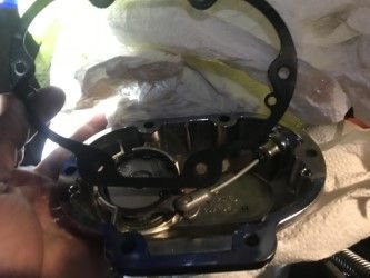

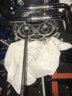

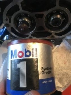

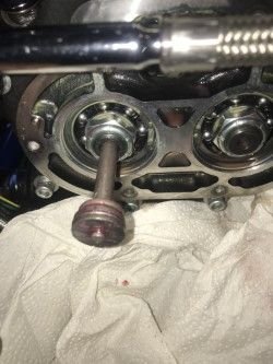

SO WHEN TALKING TO THEM, THIS WAS NOT IN INSTRUCTIONS, THEY HIGHLY RECOMMEND SOME TYPE OF GREASE INSIDE THRUST BEARING ASSEMBLY, WHICH MAKES GREAT SENSE, I LEARNED ALOT TODAY FROM BAKER, AND WHAT DIFFERENT TYPES OF TRANSMISSION OILS DO AND DON'T DO!
SO I USED RED MOBIL ONE SYNTHETIC, IF YOUR FAMILIAR OR NOT, HERES A QUICK FACT, WHEN THIS GREASE GETS EXTREMELY HOT, IT DOES NOT BREAK DOWN INTO RUNNY OIL, AND IN THIS APPLICATION IT WILL NEVER REACH TEMPS, THIS GREASE IS RATRED FOR, THEREFORE, HE SAID "DIP" ASSEMBLY INTO LUBE , LOL, WELL I APPLIED, GENEROUSLY, AND AS YOU SEE I PULLED OUT THINNER ROD, AND LUBED THAT WHOLE ROD, WITH MORE ON EACH END, AS THEY WERE BLACKENED, AND LOOKED AS THEY COULD USE MORE PROTECTION THERE.
I HOPE IM NOT BORING ANYONE, I LOVE TO SHARE FINDING, AND IF I HELP ONE PERSON, WELL ITS WORTH IT, ITS LIKE A PAY IT FORWARD, IF I HAD A NICKLE EVERY TIME ROCKER B HELPED ME, VIA EMAIL, WHATEVER, WELL ID HAVE THE 7-SPEED. LEAVE IT AT THAT, HES A VERY PATIENT, HELPFULL MAN!...

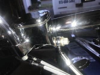

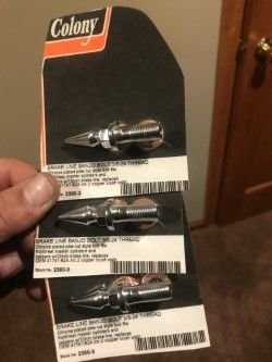

SO I HAVE THESE SPIKE BANJO'S JUST BE AWARE AS THE ONES ON THE LOWER CALIPER AND LOWER MASTER CYLINDER ARE 3/8" THE ONE COMING OUT OF THE HANDLEBAR IS LARGER, NOT SURE, ILL HAVE TO ORDER, AS ITS A THICKER THREAD!!!....JUST TO NOTS THAT, AS I DIDN'T REALIZE, SO I SNUCK ONE DOWN LOW, NOW I FEEL
GOOD BUILDS ARE IN THE SMALL AND LARGE DETAILS, BUT WHEN I LOOK CLOSLY AT A BIKE, I WOULD NOTICE, WHERE I PLACED THIS SMALL SPIKE BANJO ON THE LOWER MASTER BRAKE CYLINDER, AND IF YOU COMPARE PICS, LOOKS ALOT BETTER THAN THAT UGLY HARLEY SILVER 12 POINT BOLT!!!
ALSO ON THE GRIPS, I HAVE THE WHOLE KNIFE THING GOING WITH LEVERS/MIRRORS ETC, AND SPIKE, WITH OTHERS, SO ON THE TOP LOOKS FANTASTIC, IN MY HUMBLE OPINION NEXT TO THESE CRAZY PRO-1 KNIFE LEVERS, $$$ BUT WORTH EVERY PENNY, BESIDES KILLER LOOK, LOL, THEY ARE COMFORTABLE!!!
I PUT A SIDE BY SIDE WITH STOCK BANJO BOLT AND SPIKE, AND TRIED TO THROW LEVER INTO PIC, AGAIN, THIS IS OFF A IPHONE, SO THE BETTER PICS WILL BE HERE, OHHHHHH 6-7 ,MONTHS, BUT TALK ABOUT TRANSFORMING!!! LOL,
