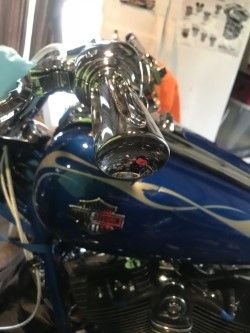

some new eye candy,
Arlen Ness Deep Groove Grips
Pro One, Knife levers, my favorite..
Kuyarkyn Banjo bolt cover and Clutch ferrule, you can see if you look where cable goes into clutch setup, its in the small details!
New Kuyarykyn led license plate holder, new style, lets all around, and beveled design on plate holder.
Viton seal, overlooked, but I don't wanna leak any oils, cause I didn't change these o rings, out
Some killer gasket seal, as I have a M6 auto primary adjuster on the way
Chrome Visor, and lenses, tint red for rear, smoke/chrome front, BADASSS
Bought new harley dual filament bullets, to house my new custom dynamics red/red rear run/brake/stop....I wasn't having red/amber????so thats that, a lot more on table, to busy working..lol
LOVE THIS LEVERS!!!! GOING WITH A NEW LOOK..
CHROME/SMOKED

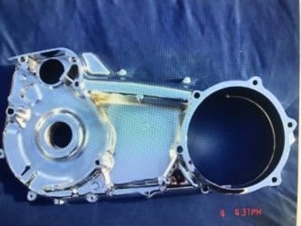

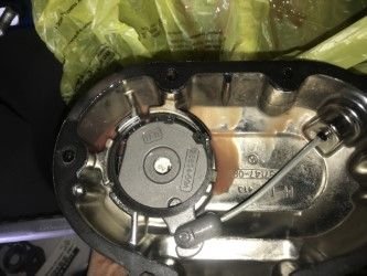

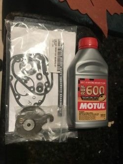

Ok so new Parts ordered last night, I haven't even put the bench worth I have sitting there in garage, no rush, rims have to be chromed, tank hasn't even arrived yet, so I'm doing it RIGHT!!!
CHROME INNER PRIMARY COVER FOR MANY MORE REASON THAN LOOKS,REASEARCH!!
HAYDEN M6 AUTO PRIMARY CHAIN TENSIONER,LOOKED AT MANY, THIS SEEMS TO BE THE ONE, OTHERS YOU HAVE TO ADJUST AND CHECK SLACK, NO THANKS, CAN DO THAT WITH THE HARLEY POS THAT CLICK UP OR DOWN, AND YES. IT LAYS 6-8 MORE HP TO PAVEMENT!!!AS WELL AS KEEPING THINGS IN CHECK, LONGER LASTING EVERYTHING!!
BAKER COMPENSATOR, POWER,RELIABILITY, IM SURE YOU ALL GET THE DRIFT HERE,FROM WEBSITE Return to carefree riding with the Baker Compensator Kit for 2007-Later Big Twins!
• Compensator Kit features improved function, quieter operation, and extended durability over the stock configuration
• These improvements were achieved by merging the tried-n-true pre-2007 cam lobe geometry with a patent pending circular oil trough that channels primary lubricant into the cam lobe region
• Kit includes 34-Tooth Compensating Sprocket, Motor Extension Shaft, Cam Slider-Spring Cup, and Retention Bolt
AND HOW ELSE TO SEAL IT ALL UP WITHOUT COMETIC GASKET SEALS, OIL O-RING, AS WELL AS WHAT EVER ELSE NEEDED ,OR THAT I CAN CHANGE WHILE DOING THIS ONE, PICS WILL FOLLOW ON JOB, ILL ONLY NEED A SECOND HAND ON STARTER BOLTS TO INNER PRIMARY, AND LINING THAT STARTER UP TO BOLT BACK IN, OTHERWISE A PROPER LENGTH PIECE OF 2X4 AND ILL DO MYSELF.
THIS THE MOST EXPENSIVE MOD, BUT I HATE THE CLUNK SHIFTING, AND DONT WANNA THROW A 3K TRANS IN THERE, ESPECIALLY 7-SPEED!!
If you have any issues deriving from your stock comp sprocket, or merely need to replace your original comp sprocket, this is the way to go. It has been no secret that there has been a serious issue with the factory comp sprockets. With poor lubrication and the spring pack failures, many have had to live with that annoying metal-on-metal CLUNK. We have engineered the solution that takes care of these issues and gives you peace of mind with quieter function and improved lubrication.

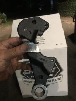

QUICK UPDATE, MY GARAGE IS PILING UP WITH PARTS, I'm waiting for custom painted tank, smoothed out, today I'm grabbing my Blue powder coated Calipers, all Diamond Engineering Hardware, chrome cables, and my rims are on there way back from Sport Chrome, along with Chrome Rear Brake Caliper Mount, CONTRAST , brakes and rims should POP,,,,, anyhow, installed the Baker Kit last night, It REMOVES the oil Spreader from assembly, twice the size throwout bearing, nice setup, I am getting the " DOOR" from Baker as well, it goes behind that trans cover, and has heavier duty bearings, ALOT stronger part , for clutch etc, look at pics, it will secure all that going on there, with better bearings!!
thats rear caliper holder I had chromed as well, btw

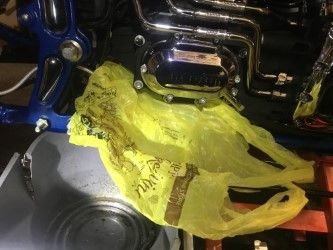

heres the Baker Street Door I ordered....
NICE SETUP, HAD TO DO IT, WHEN I SEE WIMPY PARTS I REPLACE, AGAIN THIS BUILD ISNT JUST LOOK AT ME, I RIDE, AND HARD,...LOL
The Street Door is manufactured with 6061-T6 aluminum and features 28% wider bearings over stock. The bearings are retained with a 6-bolt steel 1/8″ plate, phantom clutch lever movement is reduced by 90%. Improved transmission function is complemented with Function Formed design cues.
Increased axial loads generated by the helical gearset allow the stock door beveled snap rings to compress, allowing the door bearings to walk in performance applications. The Street Door corrects this shortcoming and is a requirement for any serious motor upgrade.
Installs with no modifications and includes ARP fasteners, mainshaft and countershaft nuts.
