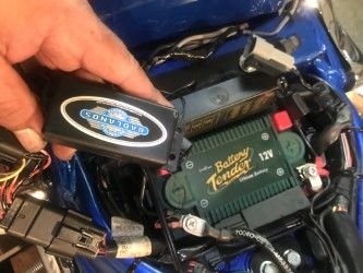

Getting power Vision, And Target Tune Set up, Wired it all up 6 Hours Of OCD making it perfet,lol
the only sloppy thing here, is that wire we have thats zip tied backwards, big plug, does nothing????but I actually have 2 o2 sensor wires going thru there, and I pulled the front o2 sensor line out of spiral plastic tube, with I ordered chrome to replace, think will look cool ,lol
had a badlands illuminator in here also for breakout rear under fender led, and all custom dynamics led....so I had to do some serious house cleaning
clean work
cleaned o2 holes, and com pressed air to clean out...

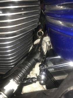

had to put a hole in top of front upper voltage regulator on top, new Wideband clips are 4 times bigger than stock ones, so there is a screw push in lock on the clips, that you can secure in hole on frame , custom holes, I since this pic, colored grey security clip with black sharpie, ordering DK Customs front chin spoiler w/vent, will look cleaner, and I wanted one anyway, this was only places with the target tune, you need to connect the ends of old o2 sensors that go to ecm, to intercept, and
thats the clip I colored, anyway real clean and secure for now.....
I looped a lot of the target tune wiring up top you can see it, I hid EVERYTHING, ALL THE OTHER CLIPS ETC, I might need a new rear o2 sensor, when I get with rear, I'm lowering oil. tank as since I put the lithium battery in there, MORE REAL ESTATE, so I can slide under that gap, the plugs to big to make it under that 1' gap!!!, but I have a perfect spot of front to park that clip....

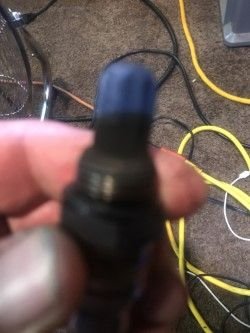

narrow band versus Wideband WHAT A DIFFERENCE
AGAIN NARROW VS WIDE, KEEP IN MIND MY BIE HAS LIKE ONLY 4K MILES, BOTH O2 SENSORS WERE CLOGGED REALLY GOOD, SO IF ANYONES using tuners, you might want to change them out, even if you don't have a tuner, the ecm cannot possibly get a accurate reading from them, this pic was after cleaning with denatured alcohol and other chemise, as I have friends w /rockers and if worked, was gonna pass this TIP on to them, like I am to anyone here, see when I do a build thread, its not just look at me,

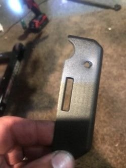

uhhh yea, speedo HAS TO GO ASAP!!!!!

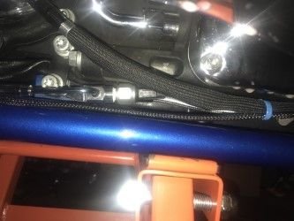

THIS WAS OPEN WHEN I INSTALLED THE BREAKOUT FENDER, SO I INSTALLED THE BREAKOUT, SPLASH GAURD?

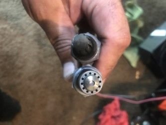

back to the o2 sensors I found these, only 4k miles, and the guy before me, was some rich dude who had a bunch of look at me bikes, unfortunately for me, he didn't 'hook' this one up at all...lol. but he rides around his development and thats it, they had service records every year, all oils, etc, etc, look at these....still not wanting to change them out/
exactly where does it sample the exhaust gasses? thru what holes?????
Now talking with people in the know, it might not be only terrible sensors, but these need to be mounted on a slant, theres a percentage table somewhere, moisture build up and can seal them as well, like stated earlier, I cleaned that one with tiny breathers real good, now you can see the before, that was the DAY AFTER!!!!

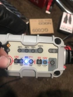

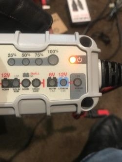

there no comparison, anyway, this is my ocd, if anyone goes lithium, i tried the schumacher, battery tender, deltram, as i have the largest lithium currently on market 480 cca battery tender aka deltram,i had a battery tender lithium charger, lasted a week, i didn't even take pics as i didn't think a charger was such a big deal, well it is, especially with lithium, when i had my hobby shop, i learned alot about lithium,lipo4 and such cells, ,years agooo, to the point where they couldn't get hot, explosion and fire was unreal, just you tube, lipo battery fire, you'll see what i mean, overcharging yielded the same results, you tube, overcharging lithium batteries, boom, so yes when it came to chargers i am picky,

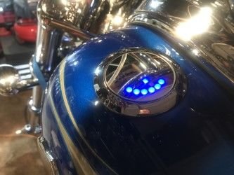

i have 1k hobby lithium chargers, which i had to use, as i made a repair during week, usuing blue leds, under tank. And did several, flashes with dyno tune, i didn't know, but that takes alot of power...anyhow brings me here, this schumacher had good reviews etc, but after the charge , i wasn't settled with the "maintenance mode" i found out, it actually trickles, which is terrible for lithium batteries, i put my fluke on, did a hold, in rush measurements etc......i knew i had to move on
well i found a forum,
where similar to audiophiles, theres battery freaks, that do the same i did, you knew???? And more....
So along came the genius charger, theres several models, that do several different things, the one i chose was perfect for my application, keeping my $300. Lithium battery tip top, for years to come....well its "maintenance " mode, is truely that, it constantly monitors, and when needed, doesn't go into a "float mode" like others or trickle, actually, starts with low low amps, making its way up to a even lower amp, or half a amp i should say, tha idle....i monitored 3 days, now i bring it to you guys, if going lithium, ill save you $$$ and lots of headaches, as the "other" offerings on market will, in some time, without. A doubt, 100 percent destroy, or shorten that lithium battery by as much as 75 percent, yes,
for the unbelievers i can forward you to, guys that dedicate themselves to testing,, and being right, and i trust these guys, not many people ill put my trust and $$ on, especially when it comes to my baby, theres 2 on this forum, and a bunch of unknowns on this battery thread, which these guys, don't just test 12 voltt motorcycle batteries, there everything and anything lithium liupo, or lipo4 etc.....

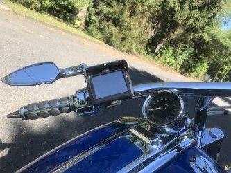

THEY SAID I CANT MOUNT THE POWER VISION ON 1 1/2" BARS, LOL, DAMM I WISH I GOT IT CHROME, OF COURSE I WAS GONNA MOUNT IT!!!!, WELL I HAVE WIRE PERMANENTLY RUN ALONG CHASSIS CENTER LINE, AND IT COMES OFF AFTER AUTO TUNING,
WHICH WAS A PLEASURE, I HAVE 2 TUNES, DYNOJET GAVE ME ANOTHER "RIDE OUT" RICHER TUNE, STILL FAST AS ALL, JUST THE OTHER IS LIKE, WHEN I WANNA GO ALL OUT, IM SOOOOOOOOOOOOO GLAD MY CAMS COME ON AT 2500 AND NOT THE BOTTOM!!!!....MY MOTOR SUCH A BEAST, I WOULDN'T BE ABLE TO DRIVE THRU TOWN,TRAFFIC, TURNS ETC,
I CRANK IT A LIL MORE, GET INTO 2500 AND ITS ON, THE CAM COMES ON LIKE A HAIL STORM,, WELL THE WHOLE MOTOR DOES, I ONLY DID 2 AUTO TUNE SESSIONS ON TOP OF :RICH" TUNE, AND I WAS SMILING EAR TO EAR, HOLY CRAP, WHAT A MOTOR PEOPLE!!!!!THANK-YOU AGAIN SCOTT FROM HILLSIDE GLAD I TRUSTED YOU
THE POWER IS EXACTLY WHERE I WANT IT, I UNDERSTAND NOW, WHY HAVING A CAM FROM THE BOTTOM ALL UP WOULDN'T WORK, I BE JERKING THRU TURNS, MST LIKELY DUMP BIKE, I MEAN ITS SO DAMM FAST AS IT IS, BUT WHEN THAT CAM COMES ON, REMINDS ME WHEN I WAS A KID W/2-STOKE DIRTBIKE, WHEN THAT "POWERBAND" KICKED IN , WELL ON STEROIDS, I CAN FEEL THE CAM, AND I KNOW EXACTLY WHEN IT FALLS OUT, LIKE 6K, ANYMORE IS RIDICULOUS!!!
WHEN IN 2-3RD GEAR IF I HIT 6K, IM DOING 100 MPH,WITHOUT A DOUBT!!!!!!!, MOTORS INSANE!!!!!RODE WIOTH BUDDYS AND HIS ZX-11 NORMALLY HE PULLS PAST ME LIKE IM STANDING STILL. WELL HE CAN DIP IN AND OUTTA CARS BETTER , OK, BUT WHENN WE HAVE OPEN ROAD, ITS NOT LIKE IT USED TO BE, MATTER FACT HE WAS CHASING ME PLENTY, AND IM NOT CLOSE TO BREAKING IN!
DID 3RD OIL CHANGE TODAY, SUPPOSED TO GO 50/200/500/1000MILES, I DID 50/150/225/300 LOL, EVERY-TIME, THERE WAS PARTICLES OF METAL, AS MY RE-USUABLE FILTER HAS THE MAGNET AND OIL PLUG, I ALSO USED LUCAS MOTORCYCLE BREAK IN OIL, I SWEAR BY IT, I SET RINGS QUICK, AND BIKE IS SO DAMM FAST, AND I DONT BREAK 250, AND WAS HOT AS HELL TODAY, AND THAT TOWN RIDING, HIGHWAY 200F NO ****!!! TUNER/MOTOR....THANKYOU!!
SO I GOT POWER VISION ON 1 1/2" BARS GO FIGURE...LOL
NICE AND NEAT,NOT DISTRACTING, PERFECT LOCATION
CHROME SUN GAURD, SO IT DOESN'T STICK OUT!

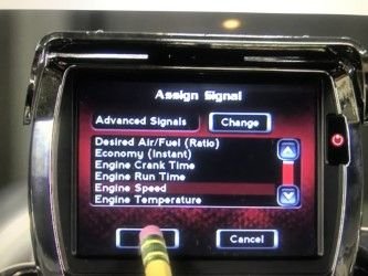

YOU GET TO ADD ADVANCED SIGNAL TO THE MANY GAUGES AND VIEWABLE CHARTS, AS TARGET TUNE WORKS OFF WIDE BAND SENSORS, GIVING ME ANOTHER 15 PLUS FEATURES TO MONITER...
I SWITCHED THIS RIGHT, F/R NEXT TO EACH OTHER, WHEN READ 100, ALL SENSORS ARE READING, WHEN I TURN POWER ON THE OTHER 2 READ THE 100, SOMETHING DYNOJET TOLD ME, TO MAKE SURE TARGET TUNE IS WORKING 100 PERCENT!!NICE!!
A COMPLETED AUTO TUNE,,,,UMMMMMM YEA ILL EGT THERE, NOT!!! HAHAHHA I THIBK THIS WAS AFTER A DYNO TUNING....I HAVE MORE THAN HALF RED THO, SO TOMORROW GONNA FINISH THE RICH ONE, THAN HIT UP JAMIES TUNE, MY LORD, I CAN BARELY HNG ON TO THIS ONE...YOU FEEL CHANGES ONCE YOU FLASH AUTO TUNE TO MAP, WHICH YOU DO AFTER EACH SESSION, SO YOU GEEL BIKE GETTING BETTER AND BETTER AND FASTER, ITS CRAZY
THATS HOW IT STARTS OUT, ALL GREEN,,,AND STAYS LIKE THIS TILL THAT RED ONE, WHICH IM SURE ILL NEVER ATTAIN, NO NEED TO, THE TARGET TUNE WILL GET ME THERE, AFTER I KEEP RIDING, IT GETS TUNING TILL, ITS SETUP LIKE THIS RED SCREEN, AND MAINTANES IT, ITS GOT COLD AY NIGHT, BIKE RAN SAME AS WHEN WAS HOT AS ****, HAD TO STOP FROM FIRST AS SON HAD 3 HOUR FOOTBALL GAME, THAN THAT A LIL FAMILY TIME, THAN WENT FOR ANOTHER AUTO TIUNE TILL 1130...LOL, TOMORROW I PLAN TO GET BACK AT IT, I CANNOT WAIT TO SEE
