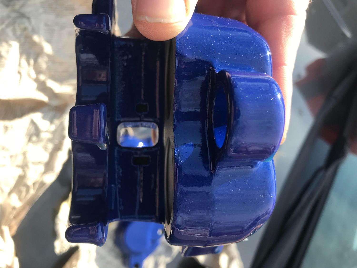

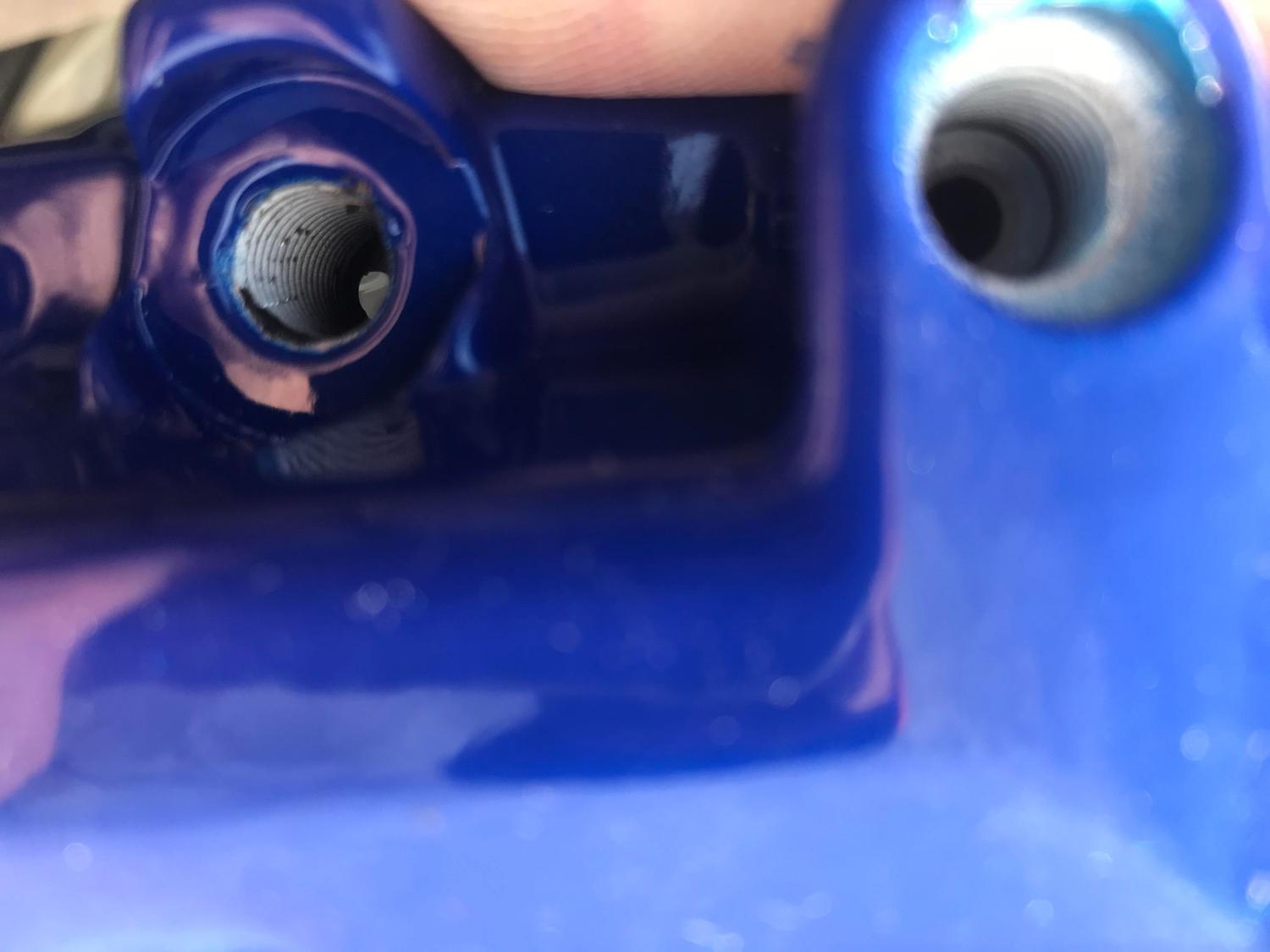

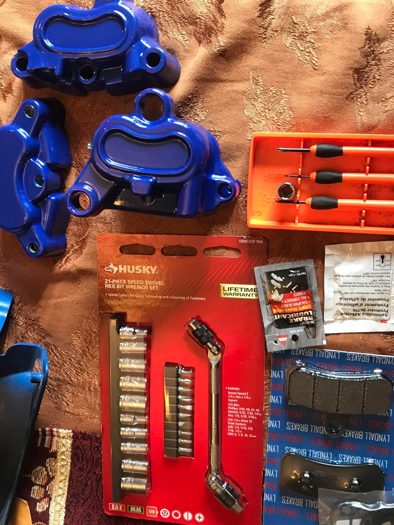

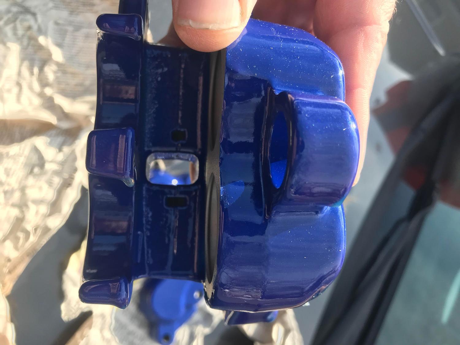

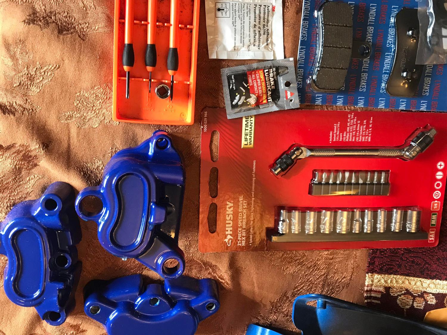

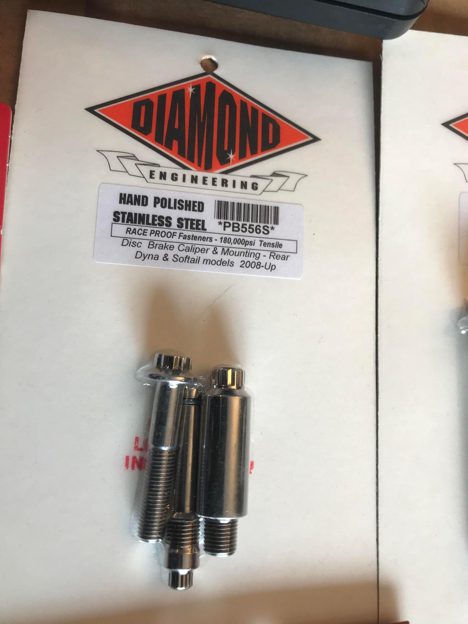

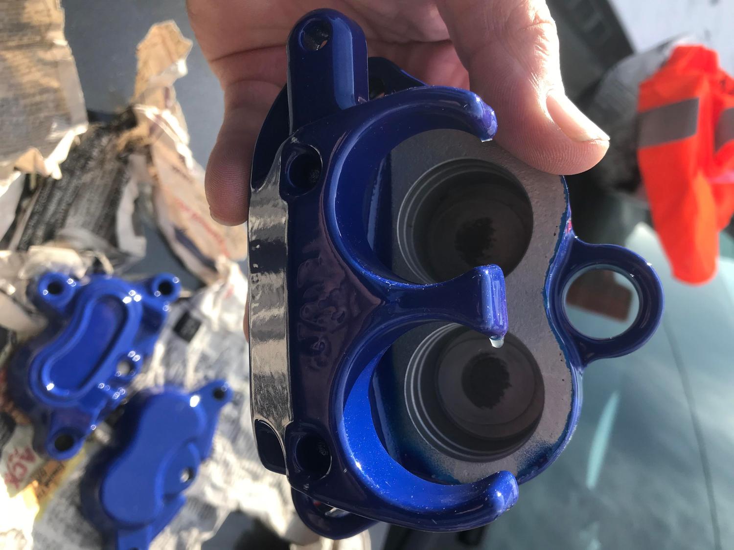

OK GOT SOME NEW, STUFF, WELL I GOT CALIPERS BACK FROM POWDERCOATER, IN PICS, YOU CANT TELL, BUT THERES A METALLIC IN THERE, VERY VERY CLOSE TO FRAE COLOR, JUST DIDN'T GET THAT "PRO" PIC, WORK 12 HRS A DAY, AND DOING TONNNNS OF WORK ON BIKE AT NIGHT....ANYHOW
I LAID OUT WHAT ILL BE USUING, THAT CALIPER GREASE SUPPOSED TO BE THE "BEST" HEARD FROM MANY SORCES, SO ILL GIVE A WHIRL

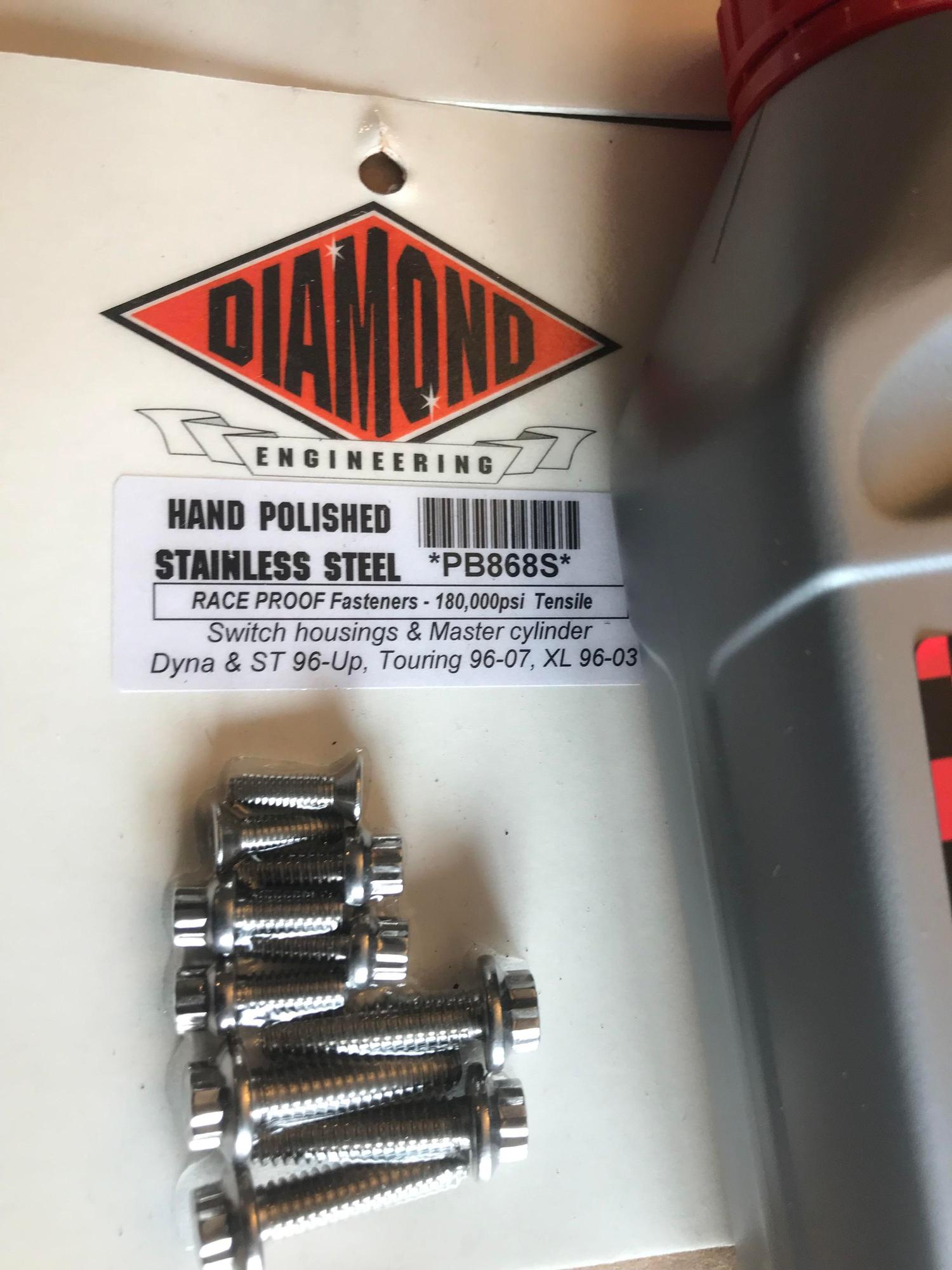

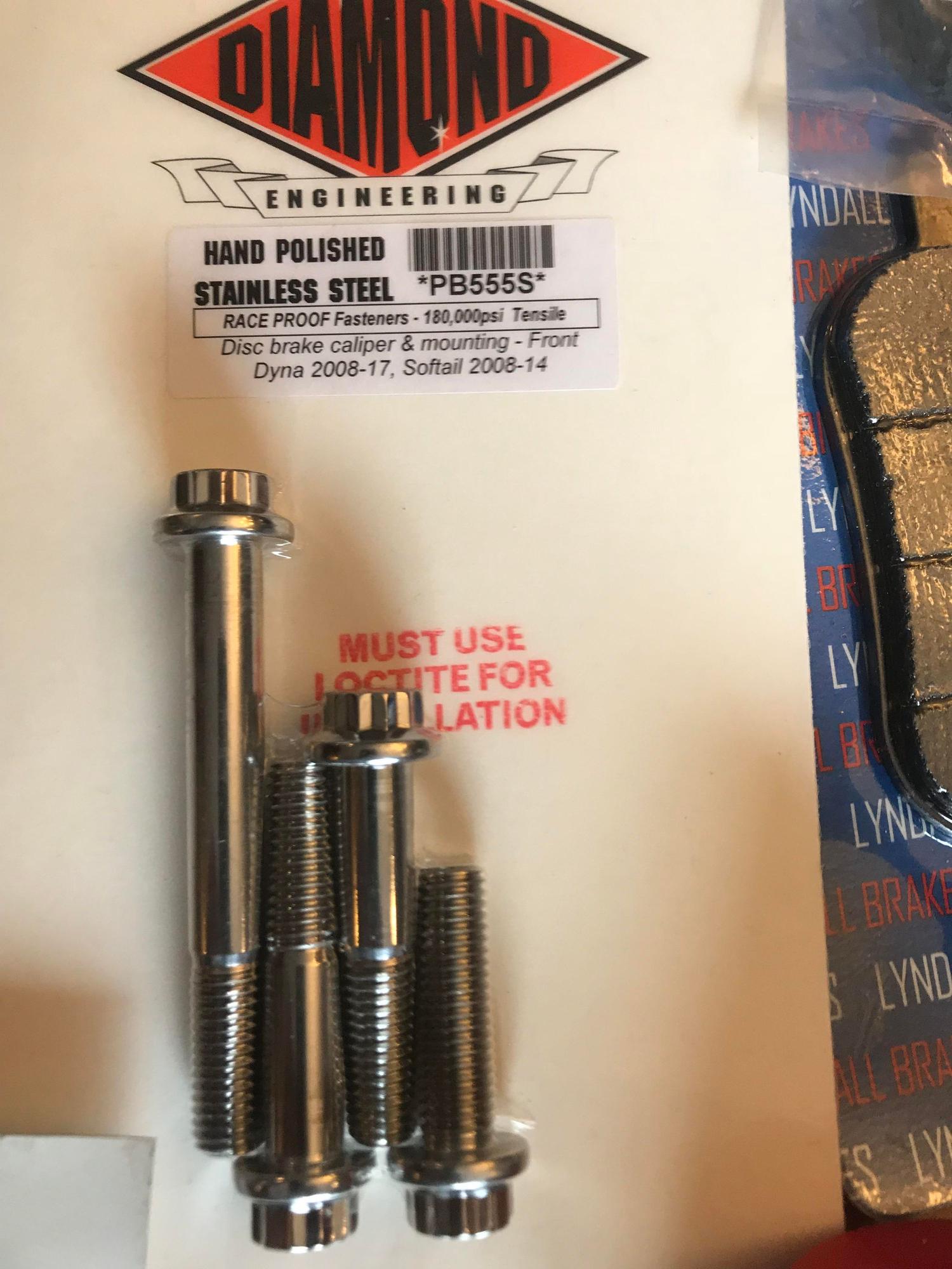

WE CAN THANK ROCKER B FOR TURNING ME ON TO DIAMOND ENGINEERING, I NOW HAVE 3-400 WORTH OF THERE H
ARDWARE ON BIKE, YOU'LL SEE WHEN ITS ALL OVER I DID IT ALL IN 12 POINT SO IT ALL MATCHES, ROCKER BOXES, PRIMARY, SHARP SHARP STUFFF, AND PISSESS ALL OVER GRADE 8
VERU EXPENSIVE, BUT IM A FIRM BELIEVER , GET WHAT YOU PAY FOR....

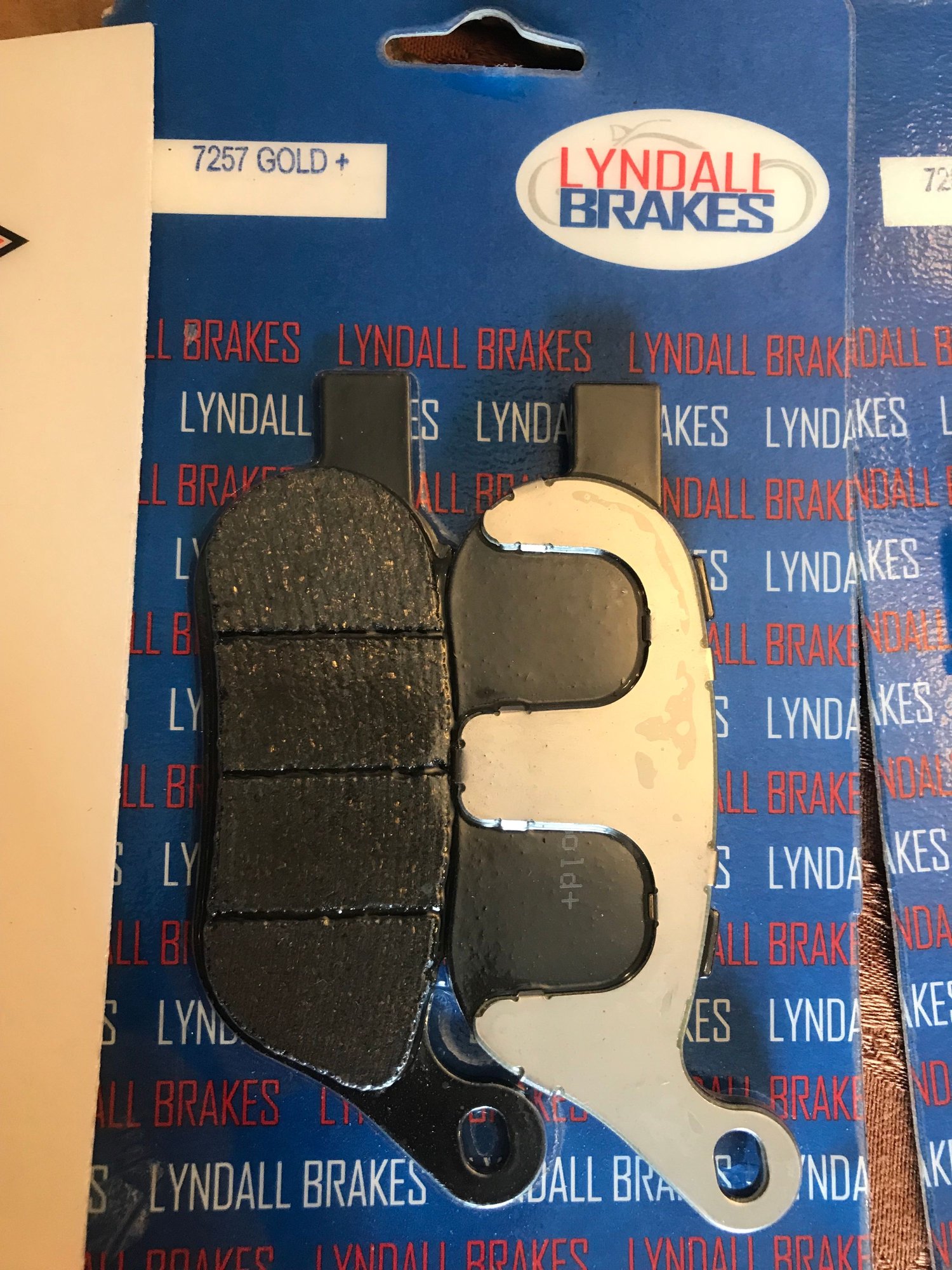

NOW THOSE ARE THE BEST PADS ON THE MARKET, I BOUGHT DIRECT, AS THE OLD ONES WERE GOLD, AND THERE AL OVER INTERNET 60$ A PAIR, THESE STOP EXCELLENT, ORGANIC, LEAVE ALMOST ZERO DUST FOR MY NICE NEW ROTORS, AND FOR CALIPERS, DONT THINK BORING BLUE,.,.,
"THINK OUTSIDE THE BOX!!"" I HAVE ALL CHROME "JEWELERY" HARDWARE, I CHROME DIPPED REAR CALIPER HOLDER, I HAVE THE HARLEY LOGOS, I HAVE POINTED BANJO BOLTS, CHROME, AND THE MAGNUM SHIELDING CHROMITE 2 CABLES, AGAIN THANKS TO ROCKER B, ****, HONESTLY, I HAVE TO GIVE A SUPER HUGE THANK-YOU WHEN THIS IS ALL OVER, IMEAN I EMAILED HIM 100'S OF TIMES, ALWAYS RESPONDED, HELPED ME IN SO MANY WAYS, I MEAN, HES A SOLID DUDE, BUT
WE ALL KNOW THT, IF YOU NOW HIM THAT IS!!!

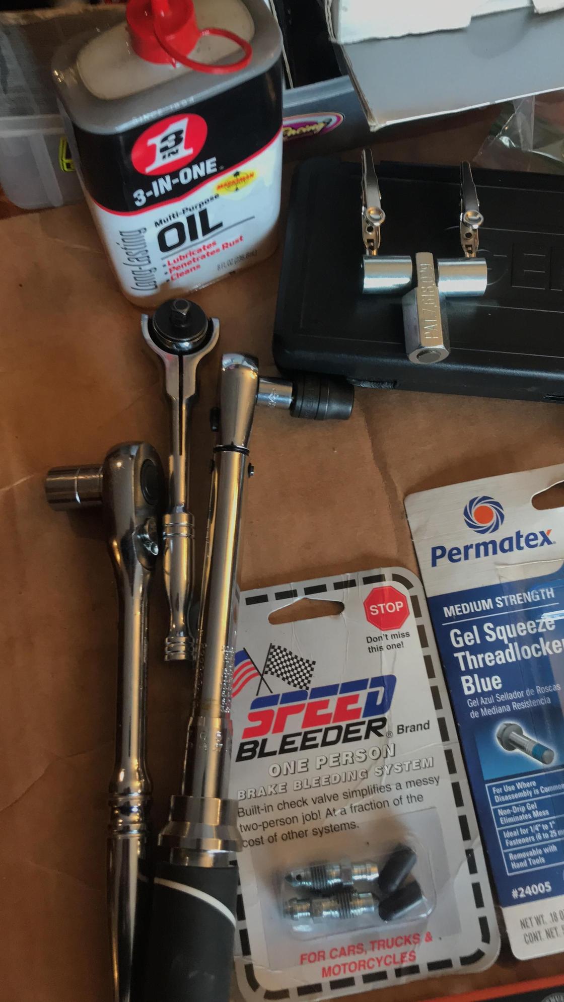

I WANTED TO "TRY" THE GEL, NEVER USED, AND WITH THE USUAL, LIQUID, I USUALLY OVER SATURATE BOLT, OR GET ALL OVER THE DAMM PLACE, LOL, READ REVIEWS, WENT ON PERMATEX SITE, SAME HOLDING STRENGTH, OH I ALSO USE A WHITE THREADLOCK,
I NEVER SEE IT MENTIONED IN HERE, WITH ALL THESE ENGINE BUILDERS, SORRY NOT ******* ANYONE, RESEARCH THIS WHITE STUFF I JUST TOOK PICS, AND YOU YELL ME HOW YOUR GOING TO THREADLOCK, AND ENGINE/OIL RELATED HARDWARE, OR FOR THAT MATTER ANYTHING THAT GETS HOT!!
, WELL WHEN I HAD MY HOBBY SHOP, AND THESE 900$ R/C RACE MOTORS, WE WOULD REBUILD WITH WHITE THREADLOCK, ILL TAKE PIC W/TOLERANCE VES,MATCH UP WITH HOLDING STRENGTH, YOU'LL BE PLEASANTLY SURPRISED, I NEVER SAW THIS IN ANY STORE, BUT ONLINE YOUYLL FIND IT....
SO WITH THE MOTION PRO BLEEDING SYSTEM, WHICH I USED ON MY QUADS AND DIRT BIKES, WORKED AWESOME, ONE MAN JOB, VERY LITTLE WASTE, I DID THE WHOLE PUMP DEAL, ETC, NOTHING, IN MY CASE WORKED BETTER THAN THIS TOOL, AND THE SPEEDBLEEDERS UP THERE, THERE BASICALLY A CHECK VALVE TO KEEP AIR OUT, SO I DON'T HAVE TO SQUEEZE HOLD, TIGHTEN, LET GO OF LEVER , RE PEAT, ALTHO THATS EXACTLY WHAT IM GOING TO DO, YOU REALLY ONLY HAVE TO HOOK UP BOTH , LEAVE SPEEDBLEEDER OPEN, KEEP SQUEEZING LEVER TILL NO MORE AIR BUBBLES, ANDD MAKEE SURE YOUR ADDING MORE AS YOU DO!
I ALWAYS GET A BUDDY TO DO THAT MINDLESS, BUT VERY IMPORTANT JOB....FORGET THE PUMP, AS YOU AL HAVRE SEEN IN MY BUILD THREADS I ALS SHOW YOU TOOLS I USE TO GET THINGS DONE, THAT CHEAP Home Depot SOCKET SET, IS ALLL 12 POINT, SO I HAVE A 200$ SNAP. ON SET COMING, BUT FOR THE BRAKES, AND YOU SEE TORQUE WRENCH ON LEFT WITH RATCHETS, IT WILLL BE JUST FINE, I AKWAYS START WITH SMALLEST SOCKET DRIVER TO GET BOLT PRETTY MUCH ALL THE WAY IN, AS TO NOT SCRATCH HARM ANYTHING, AND ITS ALOT EASIER!!

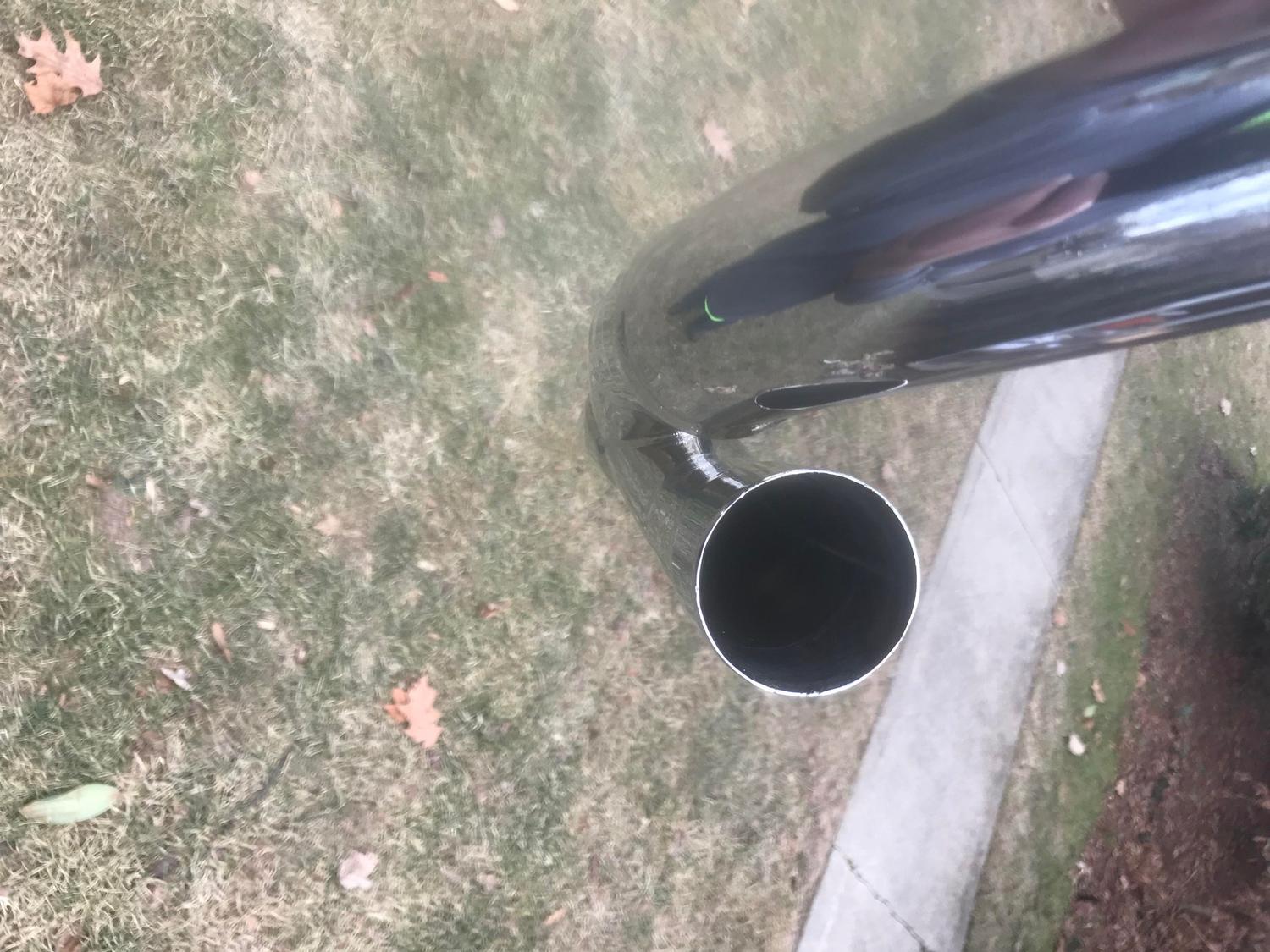

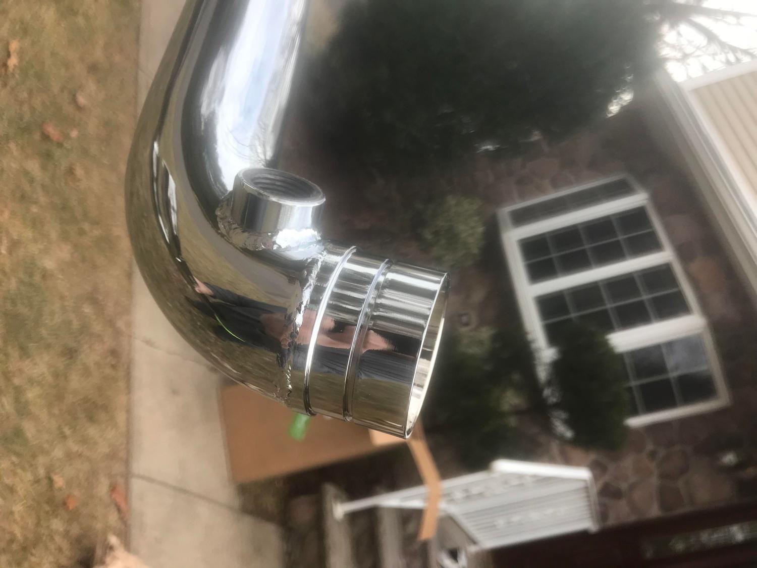

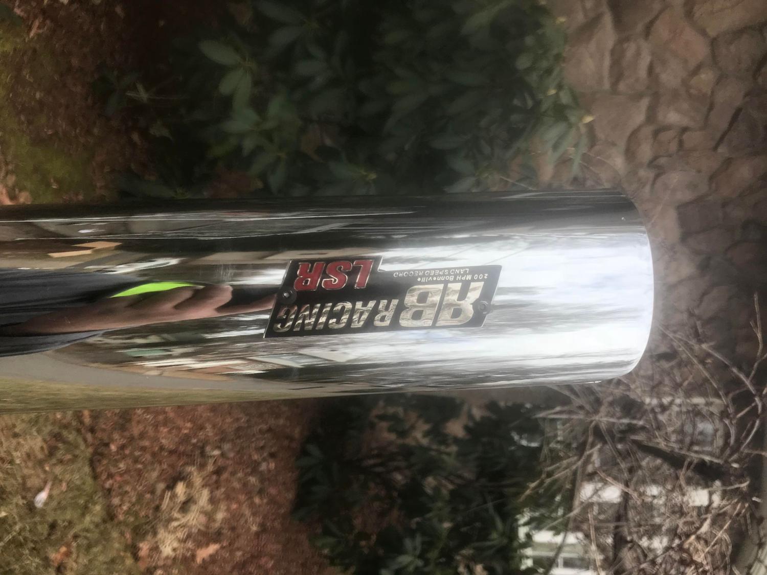

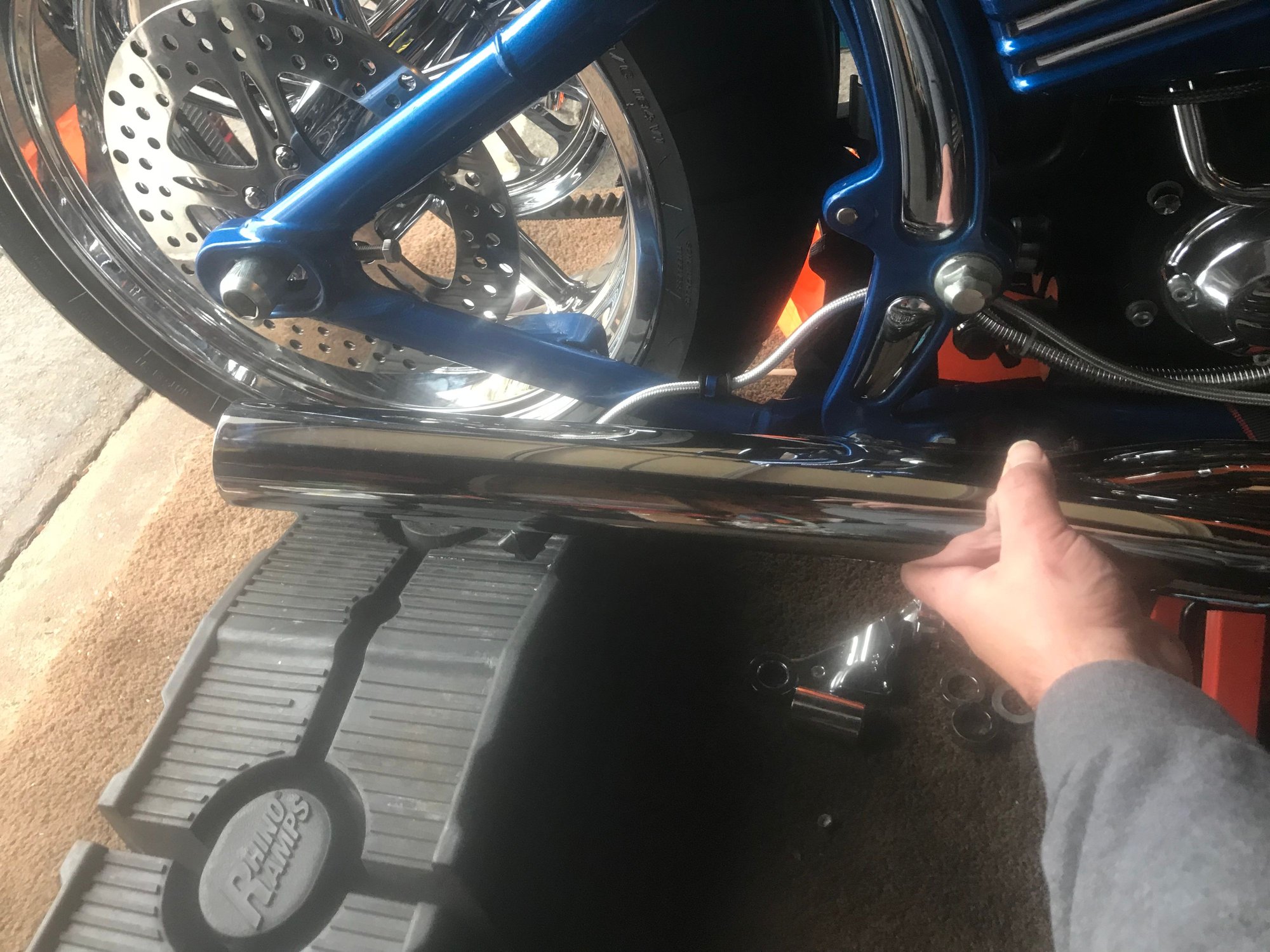

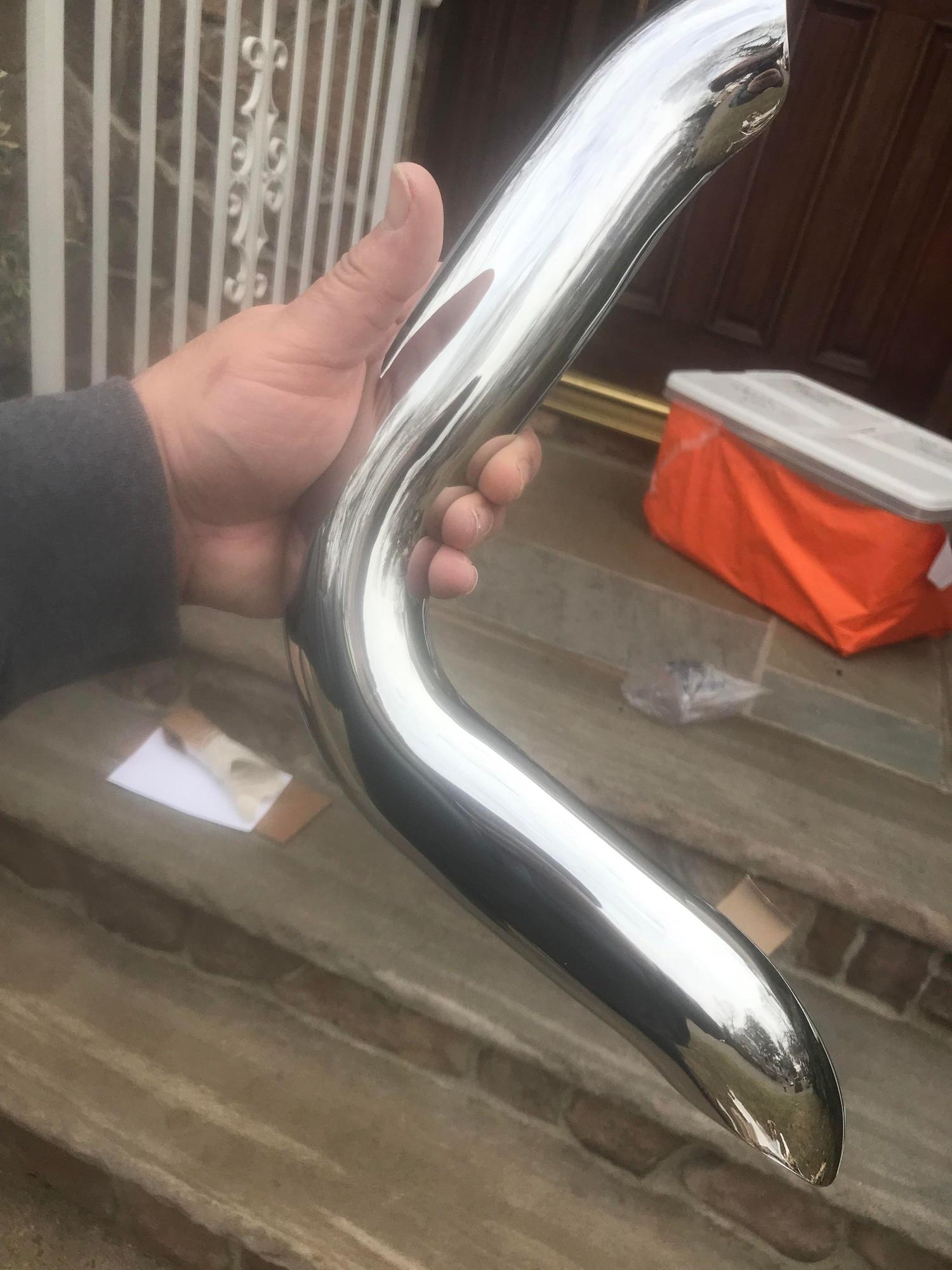

I HAVE ALOT MORE LOOK WHAT CAME TODAY, GET WHAT YOU PAY FOR, THE QUALITY IS INSANE, I MEAN IT COSTS WHAT THE PRICE OF 2 ,<2-1> GOOD SYSTEMS WOULLD COST, BUT THE FLAGES, EVERYTHING, I NEVER
SEEN QUALITY LIKE THIS, OH AND THE BRAKES ARE BACK AT POWDERCOATER, THEY DONT MATCH, HES REE-DOING THEM
THAT SECTION IS ALL ONE PIECE!!!..its too sweet ill post more tomorrow its a teaser, I want my SE Ported %%mm throttle body back, with SE injectors first but I couldn't help
he landed both 18mm bungs e x a c t l l y where dyno jet recommends them to get the best reading etc, he makes you buy the hardware ss clamps, chrome flanges, I waited a long time and let tell you I have more pics, lots I've never seen this level of attention we talked once a month, its all welded, and on other side you don't see any imperfections,
oh and btw this is the inner pipe, I have the heat shield set as well, so he treats it all with love, I get it now

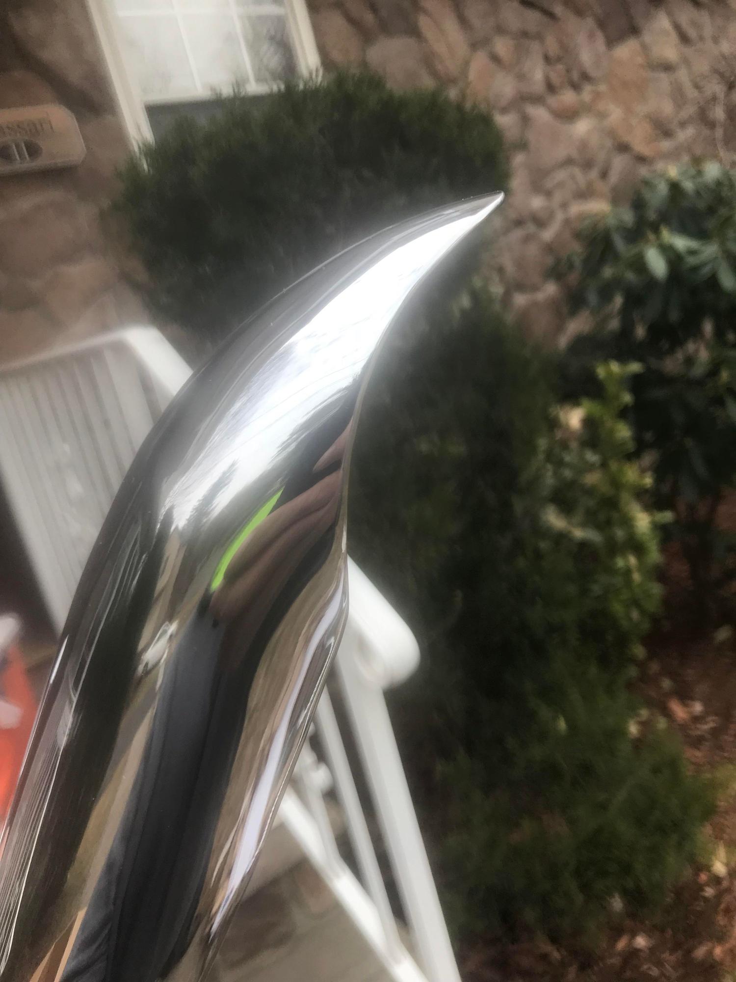

the pipe is not gonna sit as low in pic, just a idea how far back it will go, theres a shorter version, but I hit a home run, the"merge" collector, well I saw my indy putting in a basin and its nice and all, but it doesn't come together like this, and to many pieces to decelerate popping, this, I just slide one pipe EASILY INTO IT HOME, DONE,
SIMPLY AMAZING
MORE TO COME, I TRIED SO HARD TO NOT PUT THESE UP!!!
THE HEAT SHIELD CURVES ARE SOO SEXY, I mean this is a good looking pipe, my harley buds are drooling, but still. need motor part 2 to be worked, and obviously the intake, the SE. 50mm-55mm ported will hold me over, next winter, were timken mod, pinning a better s&s crank, and going 127CI BABY, YES I AM, thats why I wanna get all the head work done, I dont wanna ship a whole motor down, stronger crankshafts, believe me, im gettin ALL AND THE BEST POSSIBLE WORK DONE, I SCORED A BAKER GRUDGE BOX, WHICH WILL SIT TILL ITS NEEDED, AND IM GONNA HAVE TO GO TO A CHAIN, WITH 127 POWER...THIS IS GONNA BE A ROCKER LIKE NONE OTHER, YOU SAW ALL WHAT I DOING TO JUST THE BRAKE CALIPERS, WAIT TLL NEW CHROME/POWDERCOATED SINISTER UK HAND MADE APS 14" ARE DONE, AND I ALREADY CHROMED RIMS, WERE CONNA ADD A DRIVING 3-D EFFECT WITH POWDERCOATING!!!!

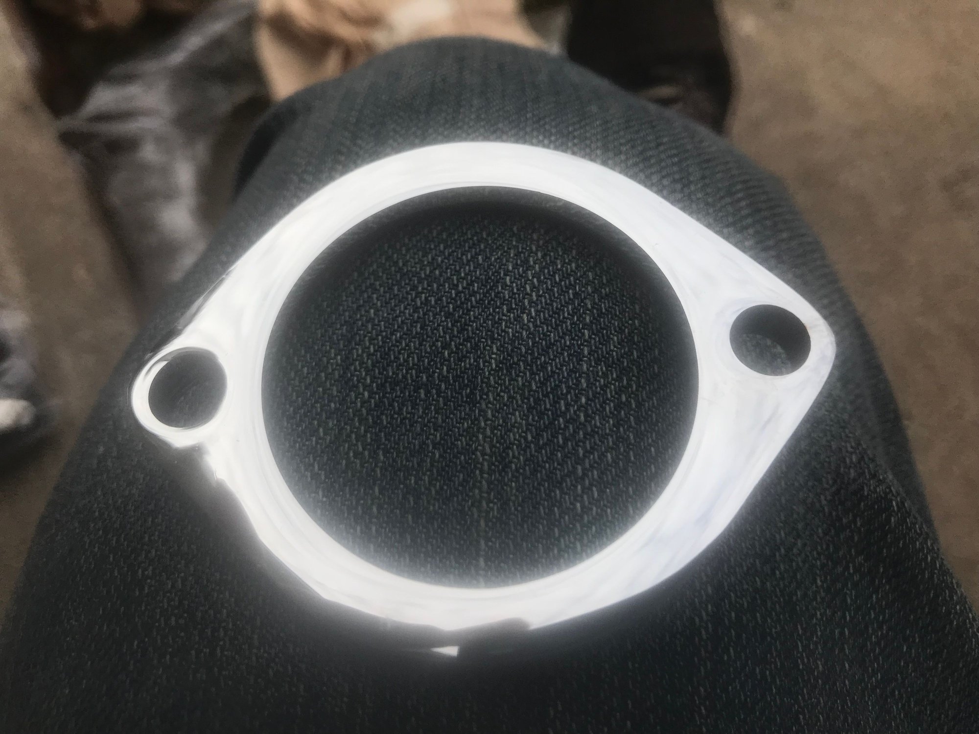

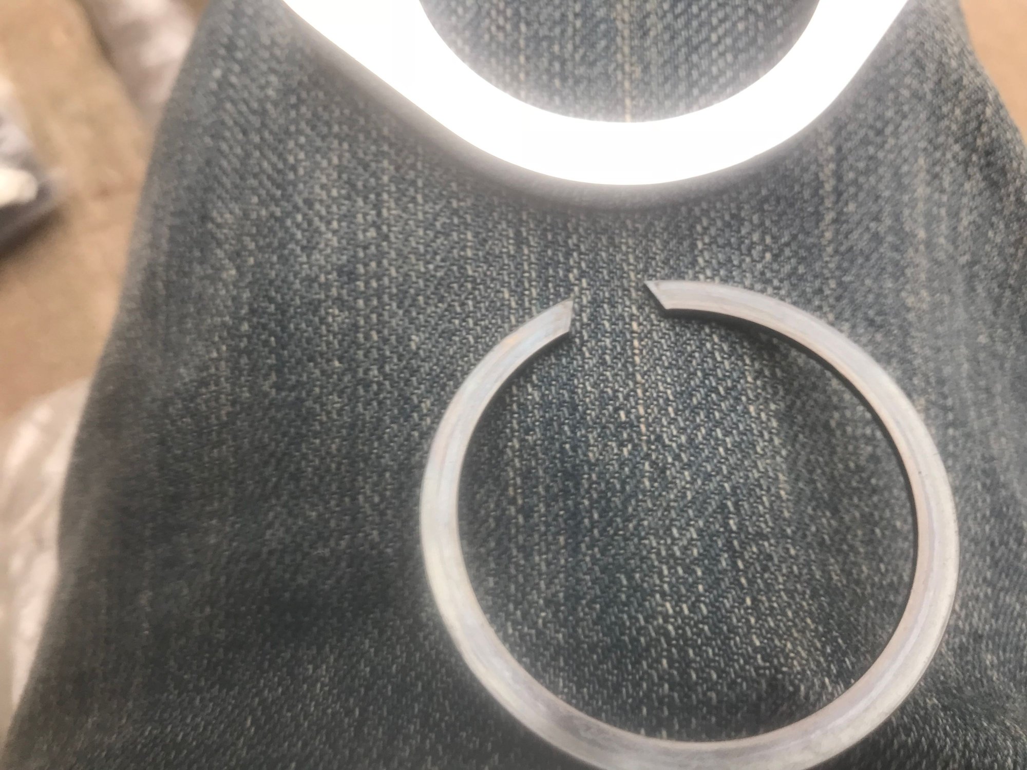

SORRY FOR DOUBLES GUYS, I WAS TRYING TO MAKE THE STAND STRAIGHT, AND ITS TURNED INTO FUBAR, TAKE A REAL REAL GOOD LOOK AT THESE PICS, AND YOU'LL SEE HERES A GENIUS MAKING THESE, THE GASKETS HE SOLD ME, HE WONT BUILD A PIPE FOR YOU IF YOU DON'T BUY HIS SEXY CHROME FLANGES, MOST IMPORTANTLY THE GASKETS, HE SAYS THE CRUCH STYLE COULD COVER 6% AND HIGER BETWEEN BOTH PIPES, HIS DESIGN IS EXTREMELY UNIQUE , WHEN I HAVE SOMEONE TO HELP ME, AND TIMES RIGHT YOU WILL SEE, UNTILL THAN I KNOW EXACTLY WHAT HE MEANT, AND I GUESS OTHER COMPANIES DO'T MAKE, CAUSE IF YOU LOOK AT THE BOTTLENECK., THE END WHERE FLAGE GOES, W/HIS GASKETS ,
