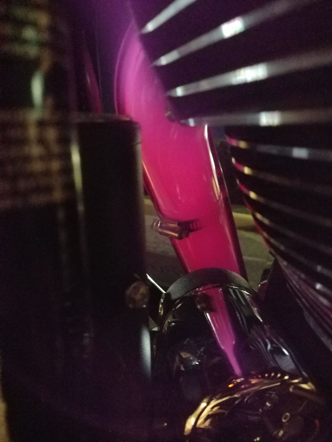

Originally Posted by Toner123
What is making you say your bike is lean? Did you get AFR readings on it?
It's completely stock, so yea it's pretty lean, and the header pipes glow red on warm up. 2 minutes of idling with 2017 emissions.
