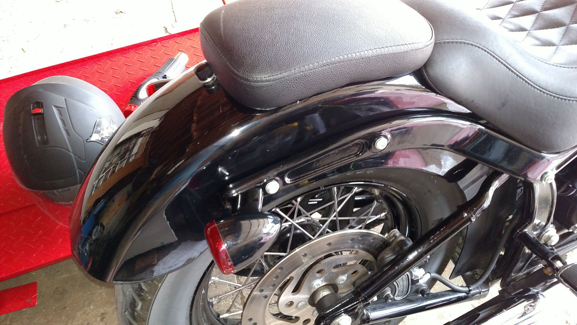

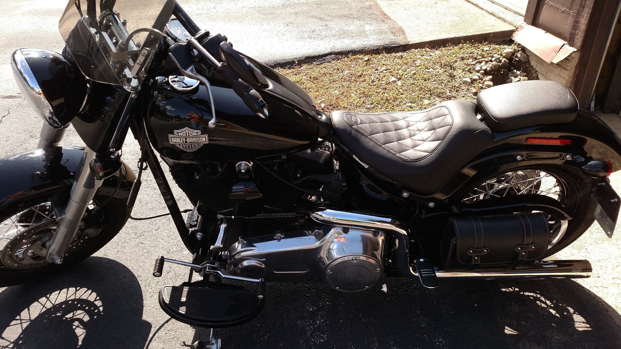

I installed V&H dual's on my '15 slim...there was a hole in the exhaust mount for mounting the pass pegs but I didn't have them....when I installed a set later there are little plastic plugs in the swing arm you can remove an use to mount foot pegs. I'll try posting a pic an hopefully you can see it in the pic:
