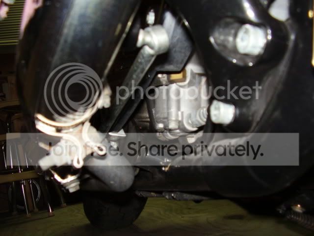

Haven't down it on my Sportster, but on my WideGlide (that I use most for long runs) I installed the mid-mount chrome bracket and pegs.
They mount right to the stock pre-drilled locations on the frame, and after a few hundred miles on the road it's nice to be able to change foot positions from time to time....
In the "UP" postion;
And in the "DOWN" postion;

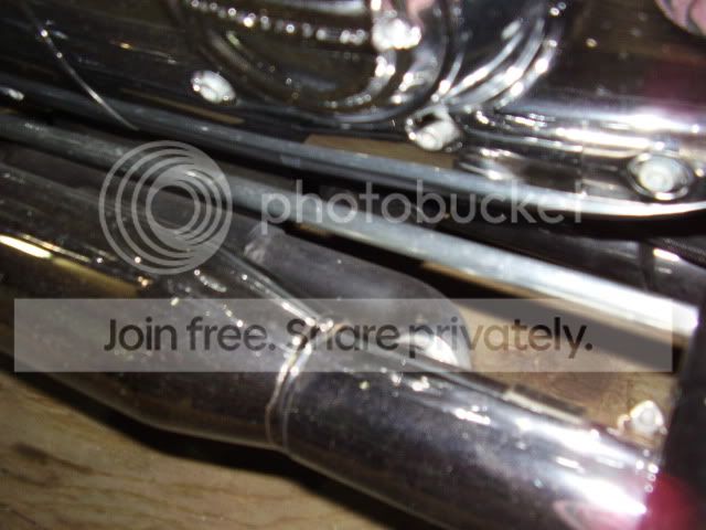

Would you explain a little more about what you're grinding? What year is your boy's bike? Thanks
2005 XL883C Shown below. You can see the two black plastic plugs inserted into the bolt holes that would receive the bolts for mid brackets. You can also see the forward control brake rod and factory exhaust connector. Not a lot of room:
