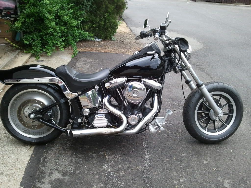

Scudda called it....might have to paint or powder coat them black though. I have a fatboy front wheel I'm wanting to get rid of cheap if you're interested. it needs a good cleaning an paint.
if you don't mind doing some tweaking you could probably use dyna wheels or any harley wheel. I couldn't find a pic of my older softail I had that came with the 9 spoke wheels on it, I swapped a deuce on the rear then a 21 spoke on the front...here's a pic of the front before I swapped it:
