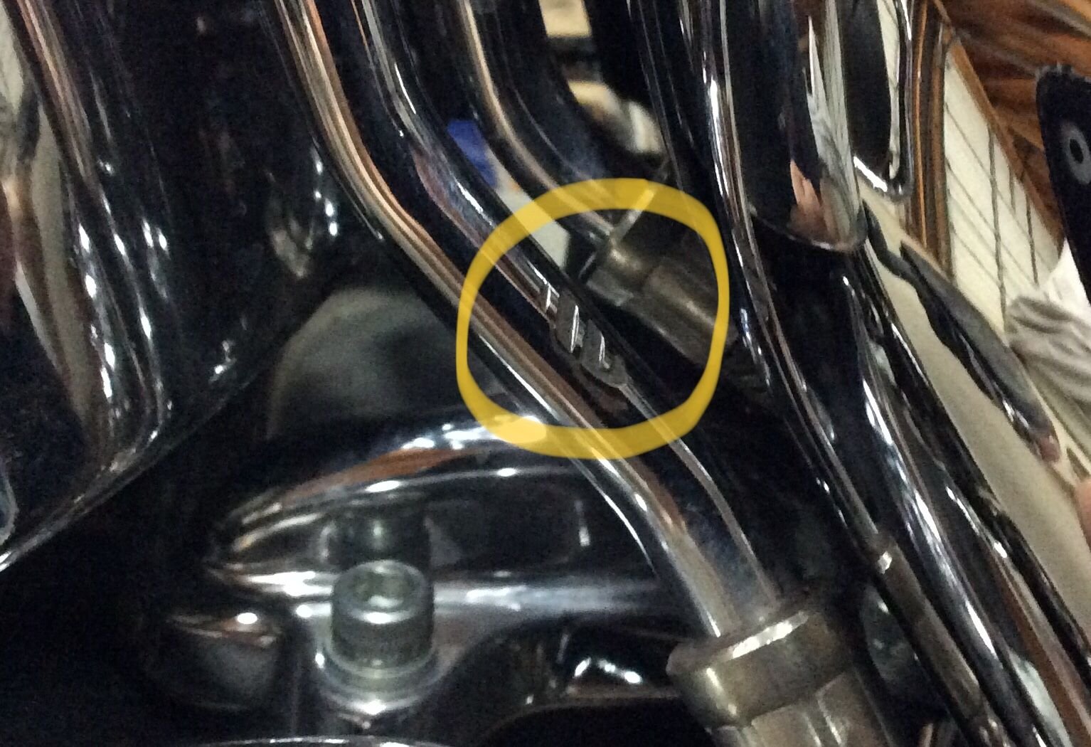

Just an FYI. First off, I'm not sure if my 2017 Heritage Classic is an oddball or if others have a similar situation. Here's the thing. I just did my stage one upgrade over the weekend. I pulled my original pipes and after I wrapped them up to save them I went back to the bike and saw a significant wear mark on one of my oil lines. Apparently the oil line being somewhat flexible was rubbing either on the pipe itself or the heat shield or heat shield clamp. I have about 8000 on the bike, but the way it looks, another few thousand and it could possibly start leaking. Just a heads up that you might want to look at.

Hi. Top pipe? Lower one? Can you tell us where and what oil line specifically? Thanks!

It is the outside line in between the two mild bends. If you message me an email address I'll send you a picture and maybe you can post it.

Yes please on the picture, I have a 17 Deluxe and I want to verify what line/location.

Here's a picture from a guy I was talking to on Facebook. This is his stock.
