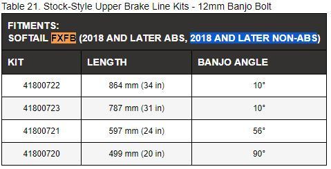

What did you do for the brakes? I put risers and bars on mine. But I can't find anything to replace the current lines.
Harley makes a few replacement upper brake lines that go from the front brake master cyl to a manifold bolted to the triple tree.
Thanks for this. Did you have to take it to harley to calibrate the abs? Or is it possible to replace the line without having to do that? Thanks.

The above will not work on NON-ABS bikes. Harley doesn't make anything for NON-ABS yet.
Nope. I did the bleed myself using a Mityvac tool. The key is to 1.) do NOT turn the bike on from the time you disconnect brake lines to the time you're done bleeding the system and 2.) Overly bleed the system. You want to be 100% sure that there are no air bubbles in the lines. I pulled about 3 bottles of brake fluid through the system through both front calipers to be sure. Overkill? maybe ... but my ABS works correctly.
You sure about that? This is straight from Harley -

From: Michigan
Postive. If you look at my thread you'll see why. I've spoken with many HD dealers over the US and they've all come up with the same thing.
I just saw your thread ... interesting to say the least. Why the hell would HD do that? Could you purchase the ABS brake like block and build a u-bent hard line to bypass where fluid would go to the ABS module?
