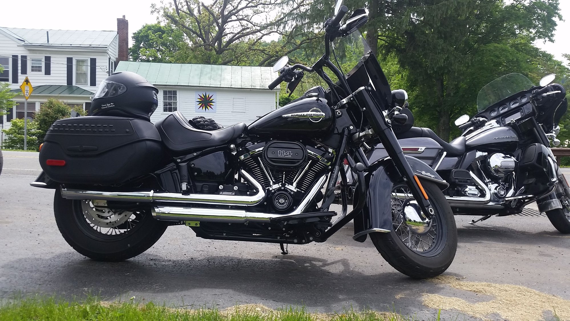

Just put on 10" pull back Bung King risers and Lucky Dave's bars yesterday. Did 130 miles today with much less back and wrist pain.

Looks good, did you have to replace the cables and do wire extensions?

They probably would have been fine, but I had extensions for the controls so I put those on and used the internal wiring slots through the risers, I didn't have an extension for the tbw so I left that down the center, it reaches.

Left the stock cables too couldn't go any higher without changing them too though.

The bike looks really good. Less pain is always a win.
