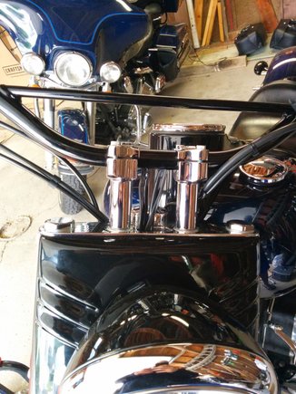

I finally caved in and bought new risers for my Slim. The slight lean forward was bothering my back on longer rides, so instead of getting mini-apes, I went for the cheaper alternative.
The risers are 3" from the base to the bottom of the bar. Drag Specialties part number 0602-0399.
I went with their split top clamp. Part number 18037506.
I was only able to go for a short ride with them on today, but the difference was very noticeable for only being 1.5" taller than stock. I highly recommend this mod to anyone looking for a little more pullback and rise out of the stock bars. For right around $90 without having to change any cables or wiring, it is a cheap price to pay for the increase in comfort.
These risers, along with the split clamp, allow the PV to be mounted front and center. An added bonus!

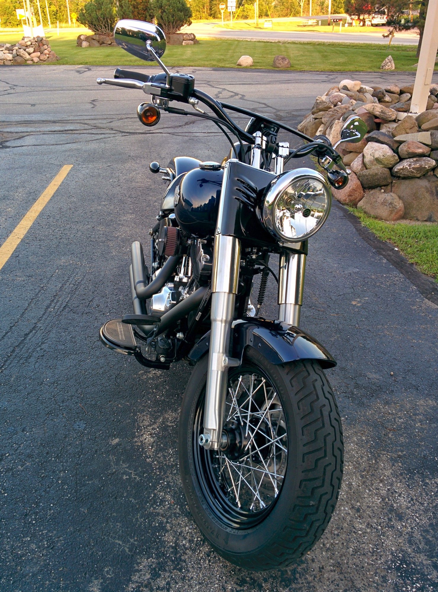

Nice. Can you provide a few shots head on and from the side of the bike? Kinda so you can see how it looks with the total package of the motorcycle.
I will snap a few more tomorrow and post them on here.

As promised, A few new photos of my new setup.

Here is another picture I took today from the front.
