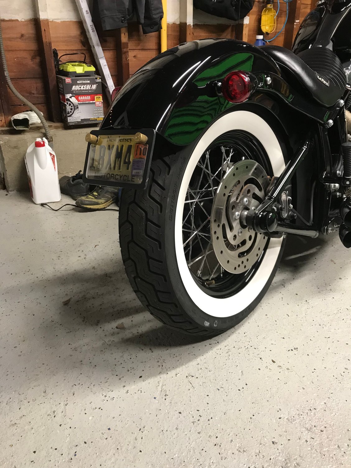

I made my own bracket using angle aluminum, pretty simple to do. Mine is a 16 slim but should work on the new one. I can get more detailed pictures if your interested in going that route.
If the pre-17 kit from Harley dont work out, I will get in contact and see what you came up with. Thanks.

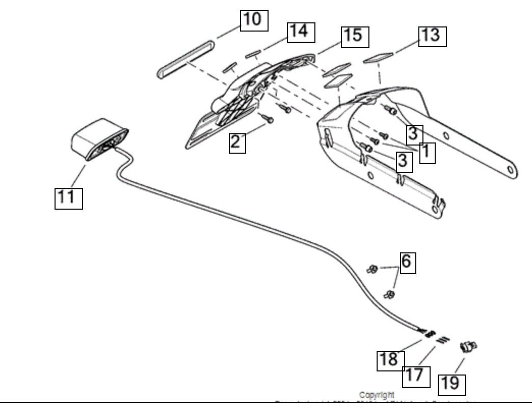

Looking at the parts in one of the on-line provided partsbooks, the 2017 looks like it would work.
https://shop.outpostalaska.com/OEMpa...BRACKETS_-_FLS

08slvr, please share your solution with us. I’m getting a Sport Glide next week and want to bring the license plate closer to the fender, like on your picture.
