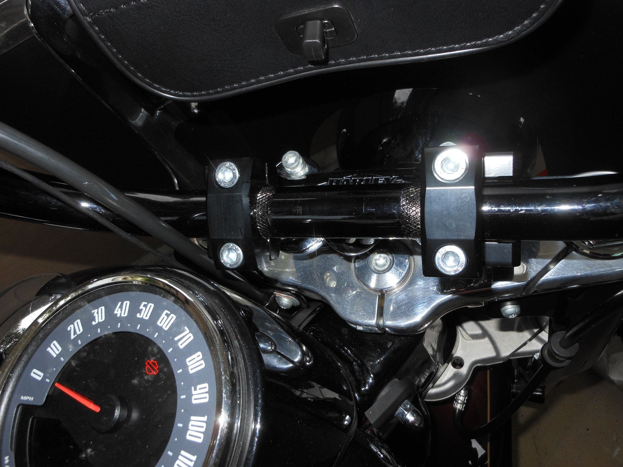

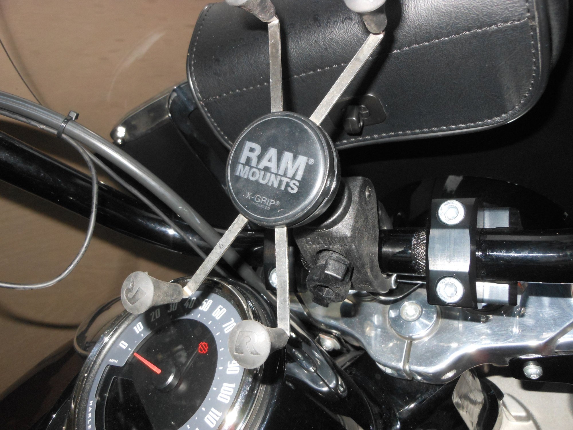

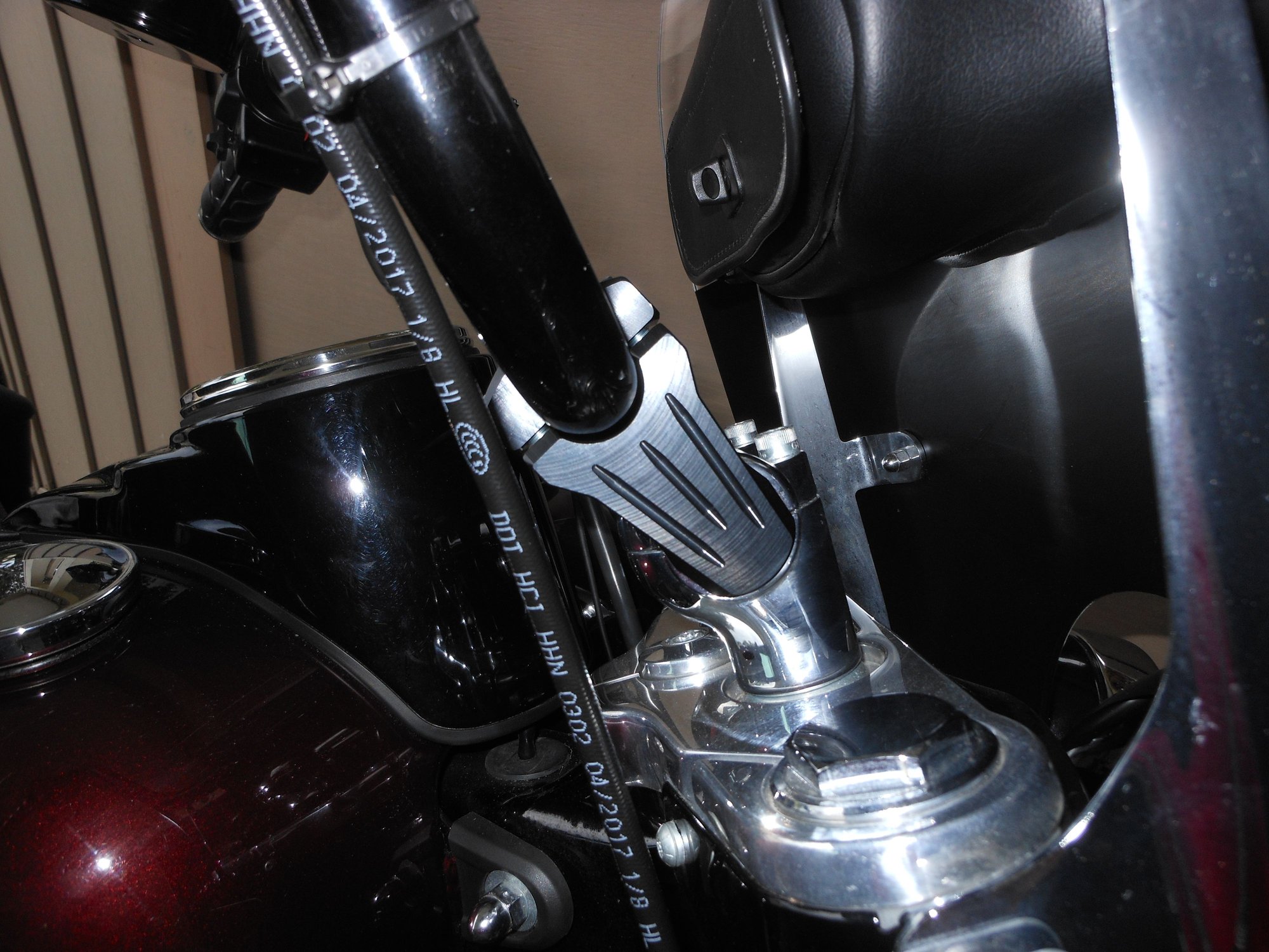

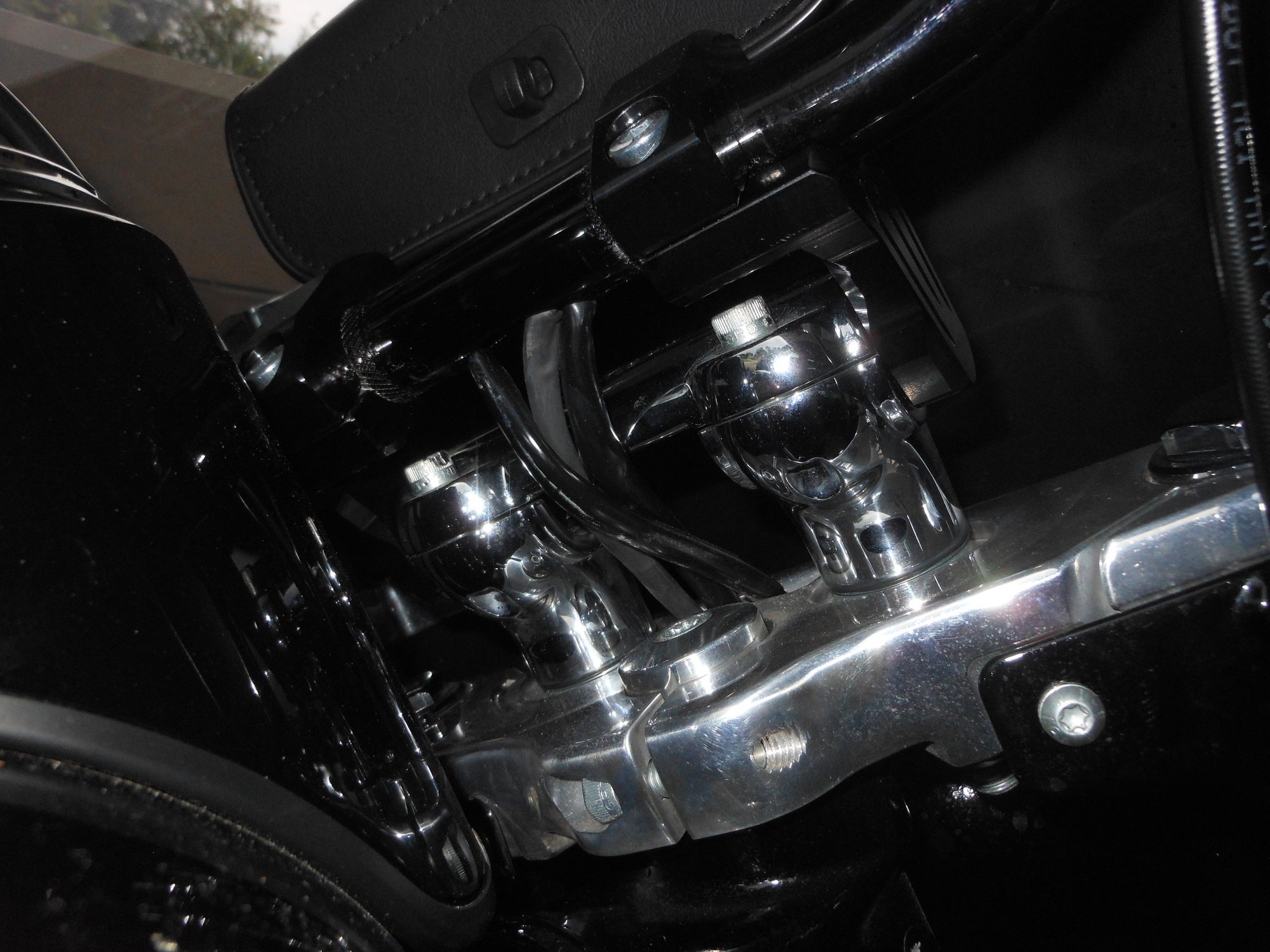

Installed Pivoting Adjustable Risers
Could probably bring them back another 1/4 to 1/2 inch
Those are the two bolts that must be tightened with a vice grip plier
Helped finding a better position for my phone mount, now it clears the speedo.
Pics as requested.
