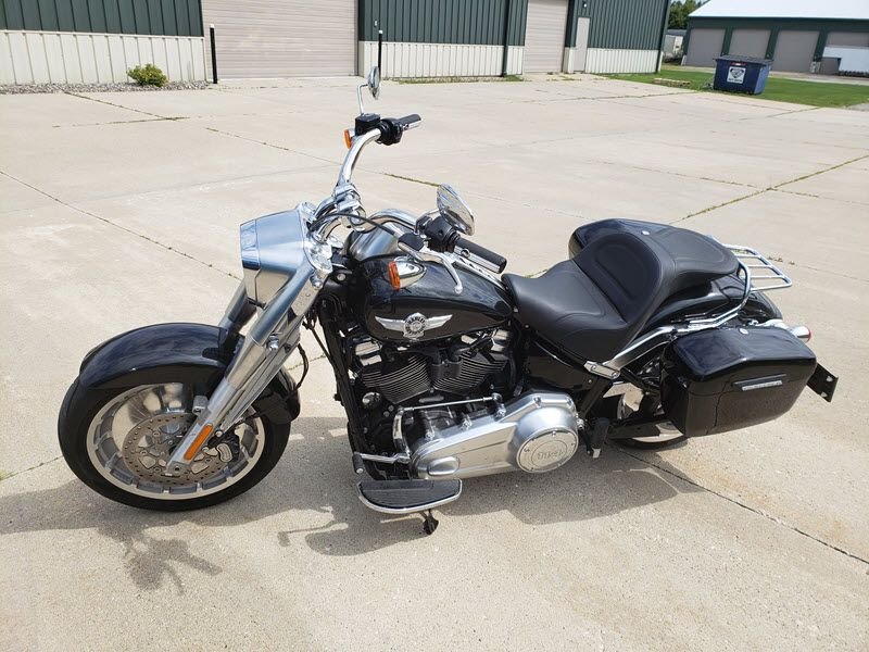

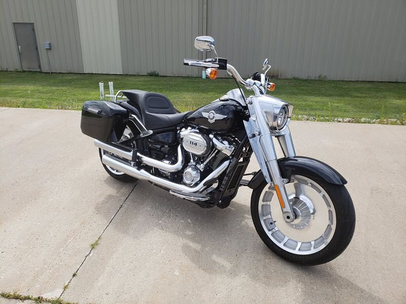

Here are a couple of full size bike pics.
Hope this helps someone.
Tom

Originally Posted by dusty1300
Finally getting back to this. Risers are on.
Here are some pics. No cable rerouting necessary, but I did adjust the rubber grommet on the fork for the front brake a little.
I do like them. Very worthwhile so far.
