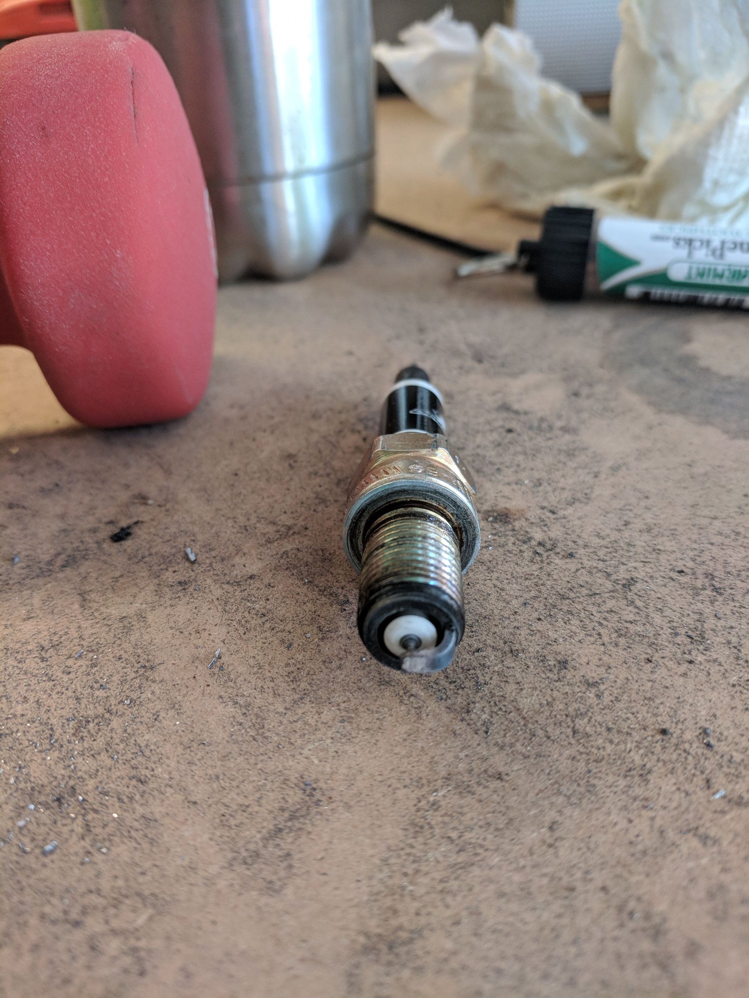

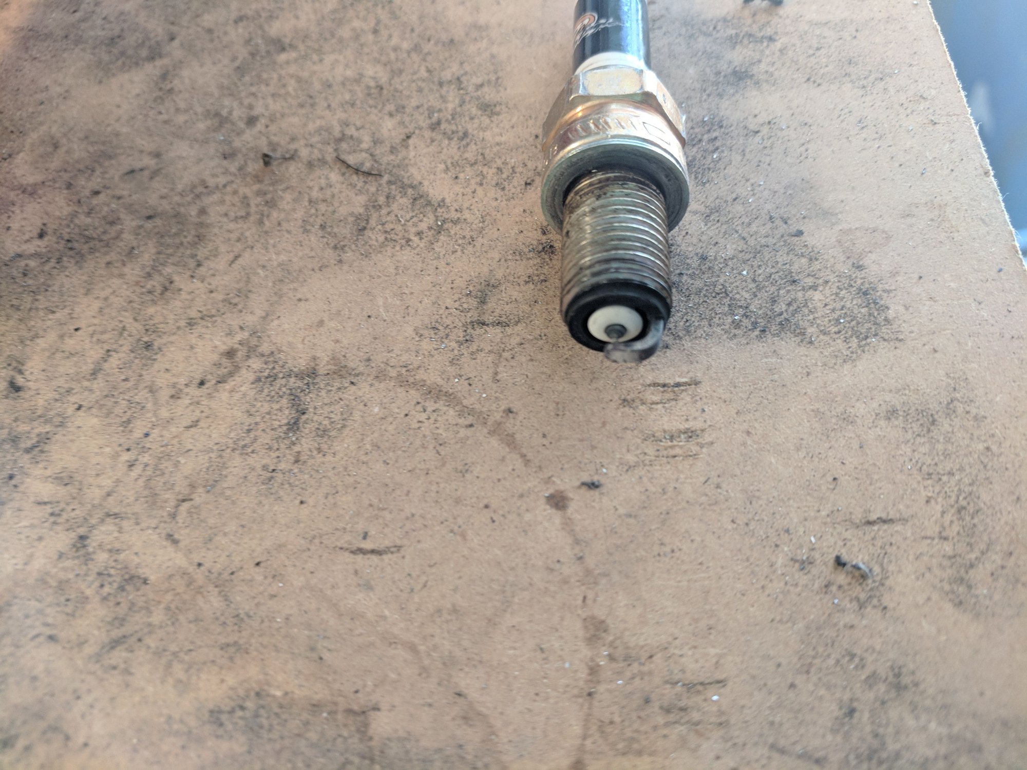

apologies for the ridiculously large pics. im attempting to do this from a phone. well, at least you can see the plugs real good :-)
Just purchased a 13 softail deluxe with v and h straightshots, baffled, and a big sucker air cleaner, thats the good news, but what may not be is im not sure it was tuned, there are some signs: excessive pop on decel. I mean..a lot. I do expect some. also, not noticing its much more powerful than the stock. I feel like stage one should be noticeable? maybe a little...maybe. Also, take a look at these plugs. I feel like they are whiter than im used to seeing? So is there any way to tune besides using the commander style things, or dyno tuning? almost miss the days when you could turn a screw...I just want it a little less lean. anyway, general opinons and help would be helpful before I venture into the shop and pay 4 bills for a tune.
thanks!

You can't get any info from the p.o.? **** can those screamin eagle plugs and get the plain Jane stock ones. Then if there's a good dyno shop available to you take it there and spend the 400 bucks...it will be the best 400 bucks you've spent in awhile. If you like to mess with your bike then get yourself a power vision and tune it that way. Personally I think we spend a ton of money for our bikes and then to upgrade parts so why short change the most important part...the tune. Unfortunately there's no cheap or easy way to tune the bike right.

no, cant get info from previous owner, bought at a dealer. but from ear memory, and a few other bikes, i know the pop is a little much - a few sound like gunfire, and i swear to god i saw a flame pop out the back at one pont....... so i go to one place, they want to hook up a laptop and tune, and give me a usb stick. forgot the name, but the next place said that was good, but old tech, and id be better off with a commander5. but another place said those dont work well after a few years - he has a stack of them that took on moisture, and went haywire. understand, im doing no more mods on this bike, so im going with powervision license for 200 and a dyno tune for 250 from a trusted shop. one and done - done right, and guaranteed. a tune and dyno can dial it in a little tighter.
