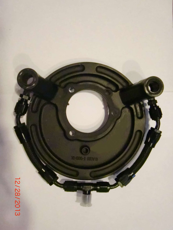

I haven't seen a good close-up picture of the under side of the oiltank area on the 2018+, so
I'm not sure how much room there is in that location. On my twincam, here's a shot of where
I located my catch-can (plumbed down from an Arlen Ness Derby Sucker)
hth,
T.
