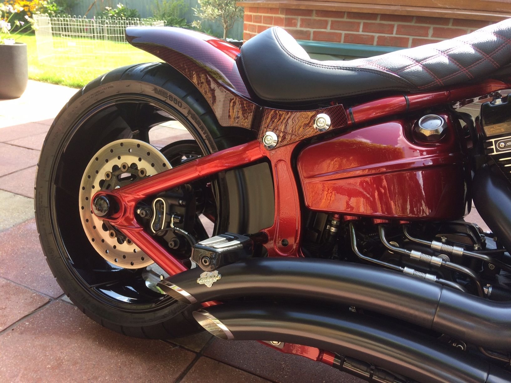

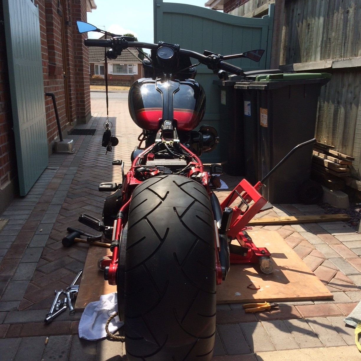

I did mine this Summer, bolts were a pain but bags of penetrating oil, perseverance and a couple of hammers on wrenches eased them out. Took me 5-6 hours as I was quite meticulous and was working alone. Until my confidence grew in the system I ran it at full height and least rebound and damping, it was uncomfortable as hell and I wondered if all the effort had been worthwhile. Once I started messing with the switches I eventually found my 'sweet spot' and it is a joy to ride and more comfortable than OEM in my opinion. I also nailed on a 260 rear tire, Thunderbike rear fender and a custom seat at the same time once they had returned from paint and the upholsterers respectively.
