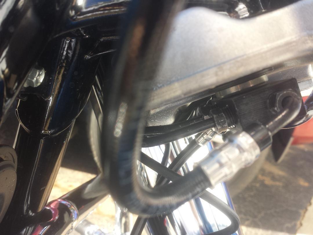

Ok so brought the bike in for the 1k service.
Had the service and parts guy look at the bike ... Long story short .. the answer to the question "Will I need to change cables if I install the six inch risers ?" was "Dunno for sure .. "
What I did find out .. wait lemme go get a pic ... brb
Old Oct 18, 2018 | 03:13 PM
sumncguy's Avatar
sumncguy
Joined: Aug 2006
Posts: 2,152
Likes: 406
From: Hurdle Mills NC
Ok .. so here is a pic of the brake hose on the fork side. You can see that the end of the line is basically parallel to the ground.
They loosen the nut and basically make the end of the brake line perpendicular to the ground which gives you another inch or two.
So the only thing I need to figure out is the clutch cable.

My FB came with 2" risers. I installed a set of 4" risers, linked below. The description says it would bring the bars back 5" closer to the rider, on an FXSTB. No way they moved them back that far on my FB, but they are closer and feel much better than stock so far as removing the need for me to roll my shoulders forward to reach the grips. I'm more comfortable than I was before. FWIW the parts guy told me that generally a 2" increase up and/or back would not be too much for the stock cables. I found that to be true, in my case.
