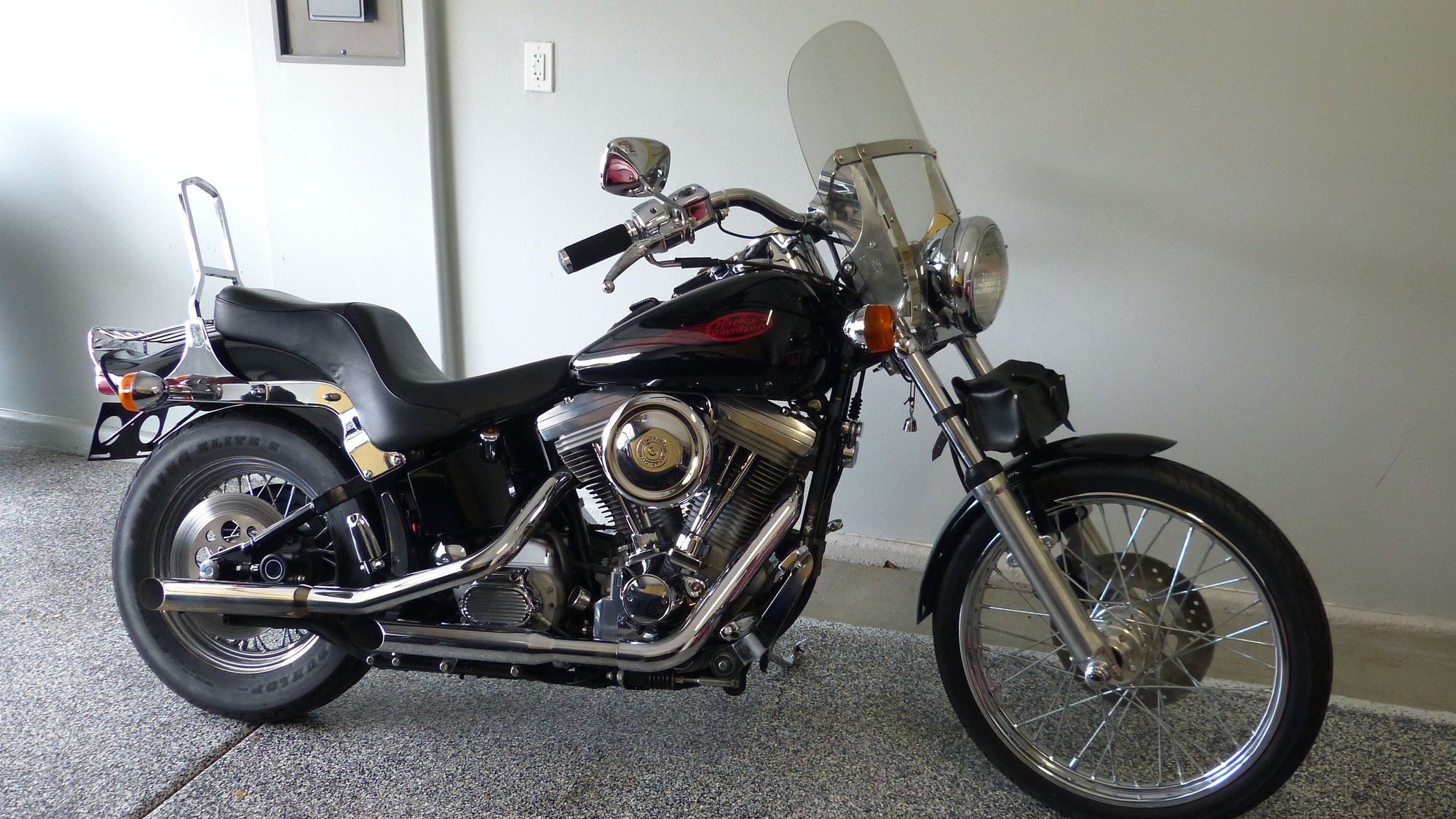

Default Softail front brakes
I just picked up a 1999 Softail Standard with the single front disc. It does everything except stop! What brake pads are you using, and do they work better than H-D/ I don't care about longevity, just stopping power.
BTW: The bike has 14k miles, and everything in the brake system works fine.
