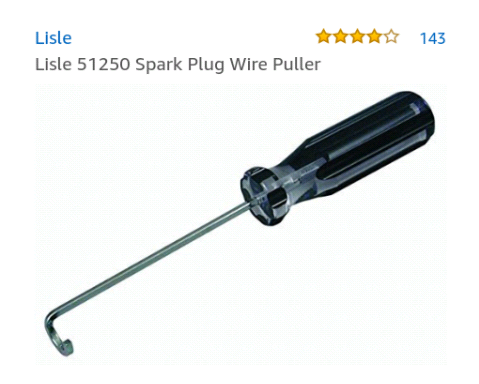

It's possible to loosen the tank, and pivot it out of the way, but if you're going that far another minute or two will have it completely off the bike. A nearly empty tank makes it easier. I also use this tool to pull stubborn boots. The right side plugs are recessed, making it difficult to get a finger grip on the boots.
