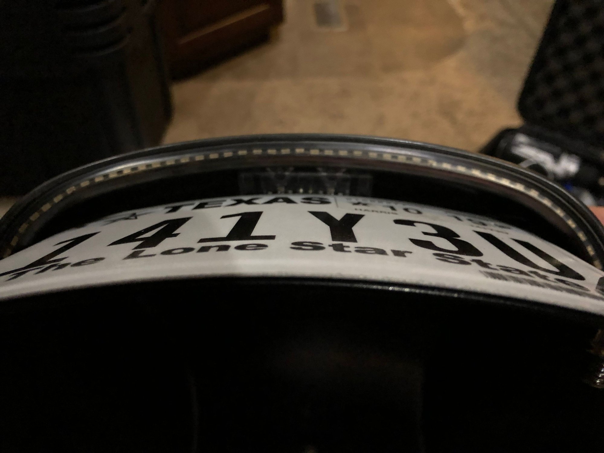

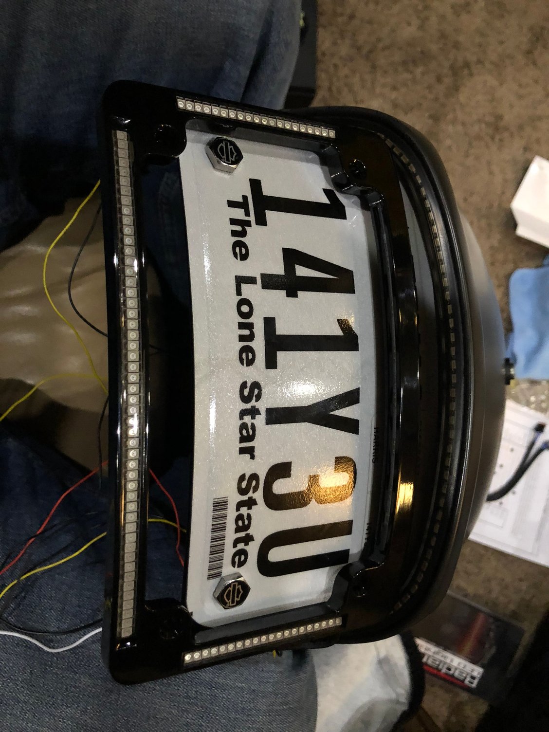

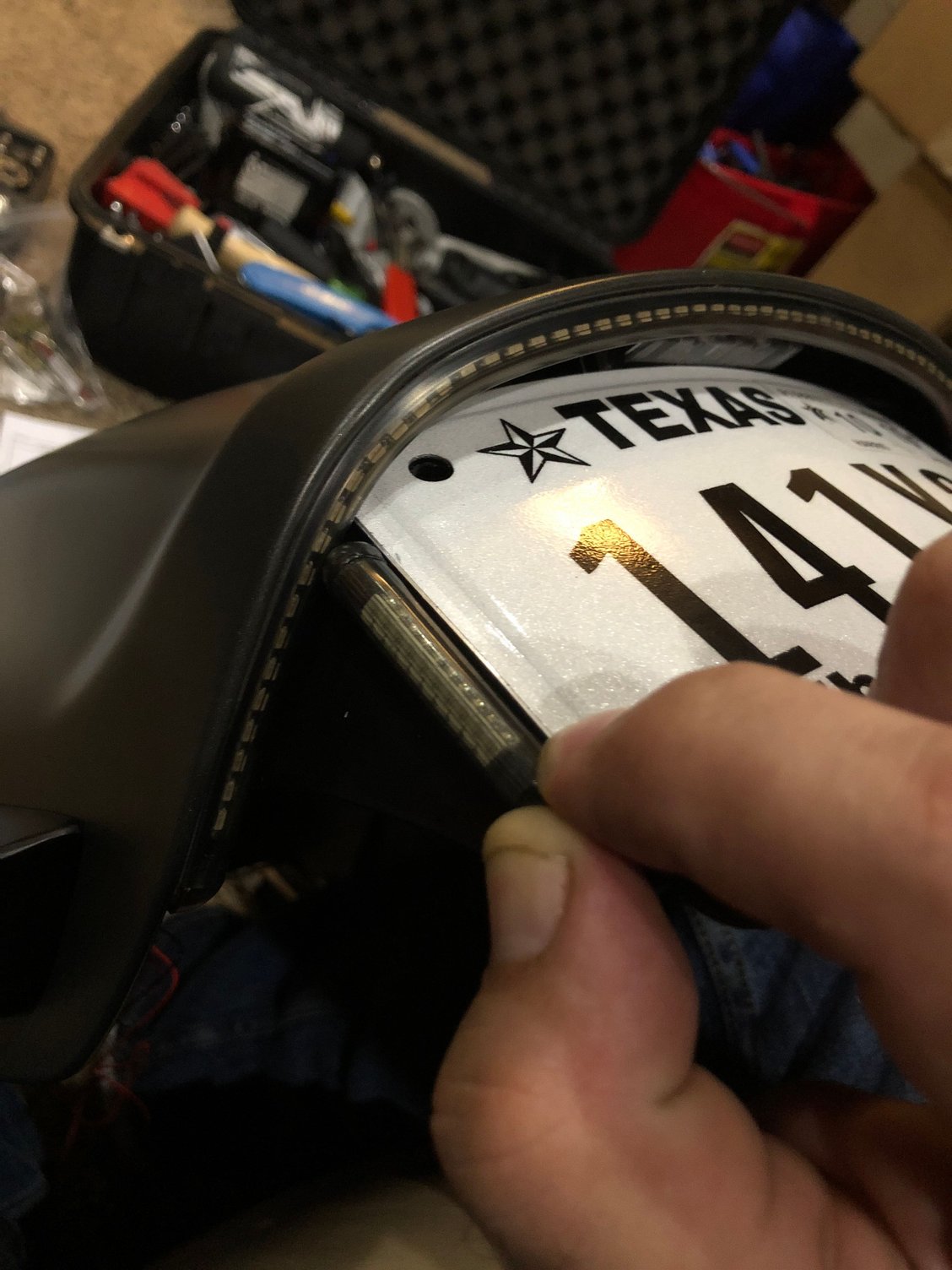

So I have the ability once I install the resistor (I have to order another one as I only had one) to dim this LED strip I have installed so I can have tail, stop and turns. The stock tag light being underneath.
Or I can install small LED strips down the side of the blackmill bracket as in the second pic for turns.
Does that look too busy?
I cant get the LED plate frame on without tearing the LED strip I have installed already out to make room.
Here is is a pic of the plate with its ton of wires. They really could clean that up with just one heat shrunk wire harness coming out at one location but otherwise it’s a nice plate and fits the curve perfectly.
I have that same plate holder from Custom Dynamics. How did you get the yellow turn signals to work? I could get them to signal when the turn signals were activated but they would also come on when the brakes were applied.

2019Fatbob, the rear turn signal circuits also carry brake power. That's how the stock bullets light up as turn signals and brake lights, and that's why the yellow light bars on the Quad-Radius frame are trying to act the same way. The only way I know of to pick up "clean" turn signal-only power on your bike would be to run wires forward to the front turn signal circuits in the wiring harness.
Alternately, you could use a Tri-Radius plate frame, which has red light bars suitable for use as brake and turn signals.
