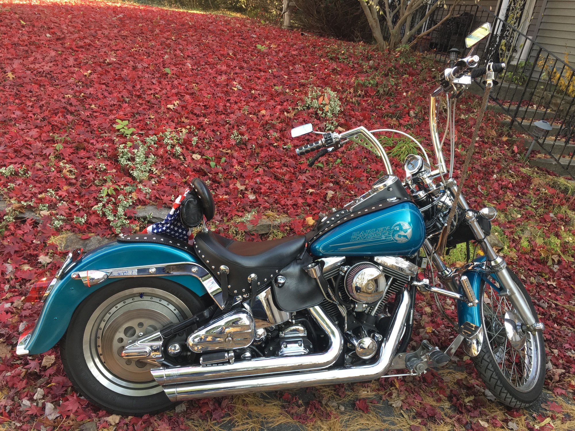

As long as you stay within the compatible years and tire width you can drill new strut holes. That's what I did on my 94 Softail Custom. I used a 98 Fatboy fender.
