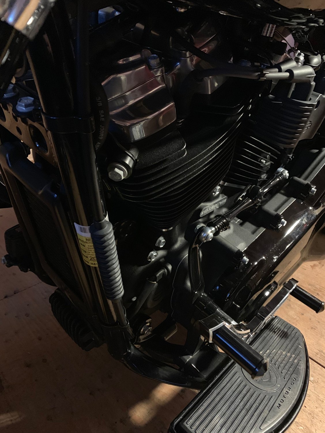

I have recently replaced my bars with Hell bent apes. We did the complete cable. Definitely like the look of the cable now.

The new bars look good!

Thank you very much dnd, I’m very happy with them. They definitely upped the fun factor.
