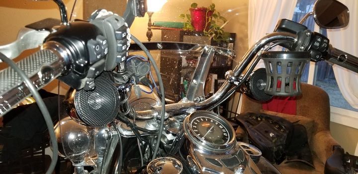

So, I am in the process of finalizing my "winter wiring" project. This involves replacing my dead Innovv K1 camera with a new, shiny Innovv K2 camera, rewiring all the janky one-offs I've added piecemeal into a cohesive setup. I have saddlebags, and unfortunately, half of one of these is the home of all my electronics. LED strips controller, Camera electronics, stereo amp, speaker wires and my trailer hitch wiring. I have a 2016 Heritage. Now, when I started this reply, I didn't catch that you didn't have bags. That makes a difference.
I'll go ahead and finish. I tested my setup before finalizing it and I think my volume is quite loud and clear. Granted, I haven't ridden with it yet, but my speakers are pretty close behind the windshield. (Pic below.)

Now, this picture isn't very good because I don't have a backdrop, but you can see the speakers mounted to my handlebars. The cupholder is probably gonna have to go.
You'll also want to connect to the switched power, or install your own switch. You don't want that amp pulling from the battery when the bike is off, or if you do, that's why you need to be able to cut the circuit for when you're not around the bike. (I like to have the LED's on during a bike night, but don't trust their "we'll shut it off if your battery gets low" nonsense, so I put in my own three-switch on the left handlebar. You can see it in the picture. Top is for my passing lamps (I hated the stock switch), the middle is for the LED strips and the stereo amp. The bottom switch is for the 12v brake controller power to my Roll-a-Home trailer, to cut the brake controller off during slow speed maneuvering.
