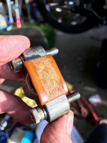

About 6 years ago, I installed Harley's "hybrid" kit. But this kit comes with most everything you'll need.
I don't believe there is a totally complete kit out there. Some pieces will need to be bought separately.
For instance, I got my cams and pushrods from Andrews.
Much has been posted about the lack of a roller chain on the back side of the hybrid kit. I just did a 30,000 mile inspection of my tensioners. Here are the pics
Front:
Rear:
Not bad in my opinion.
I did replace them with the S&S tensioners while I was in there.
YRMV.
