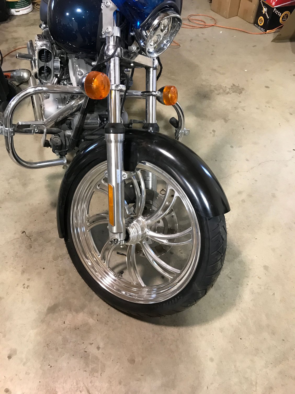

Just wondering if anyone has a heel/toe shifter on an fxst? What is needed, and why can't I find anything for my bike? I know I'll need floorboards too. Is it something I'd have to do custom? Thanks in advance for your help.
2001 fxst/i

Awesome bro! Thanks for your time. Would I have to get rid of my highway bar? Or is the toe shifter the same length as the stock one?

It should not affect/interfere with the engine guard, is that what you mean by highway bar?
The single shifter has a bend to it, while the heel/toe shifter is straight.... I don't have an engine guard on my 2001 FXSTS, I do have an engine guard on the bagger & Heritage, the heel/toe doesn't interfere with them....
