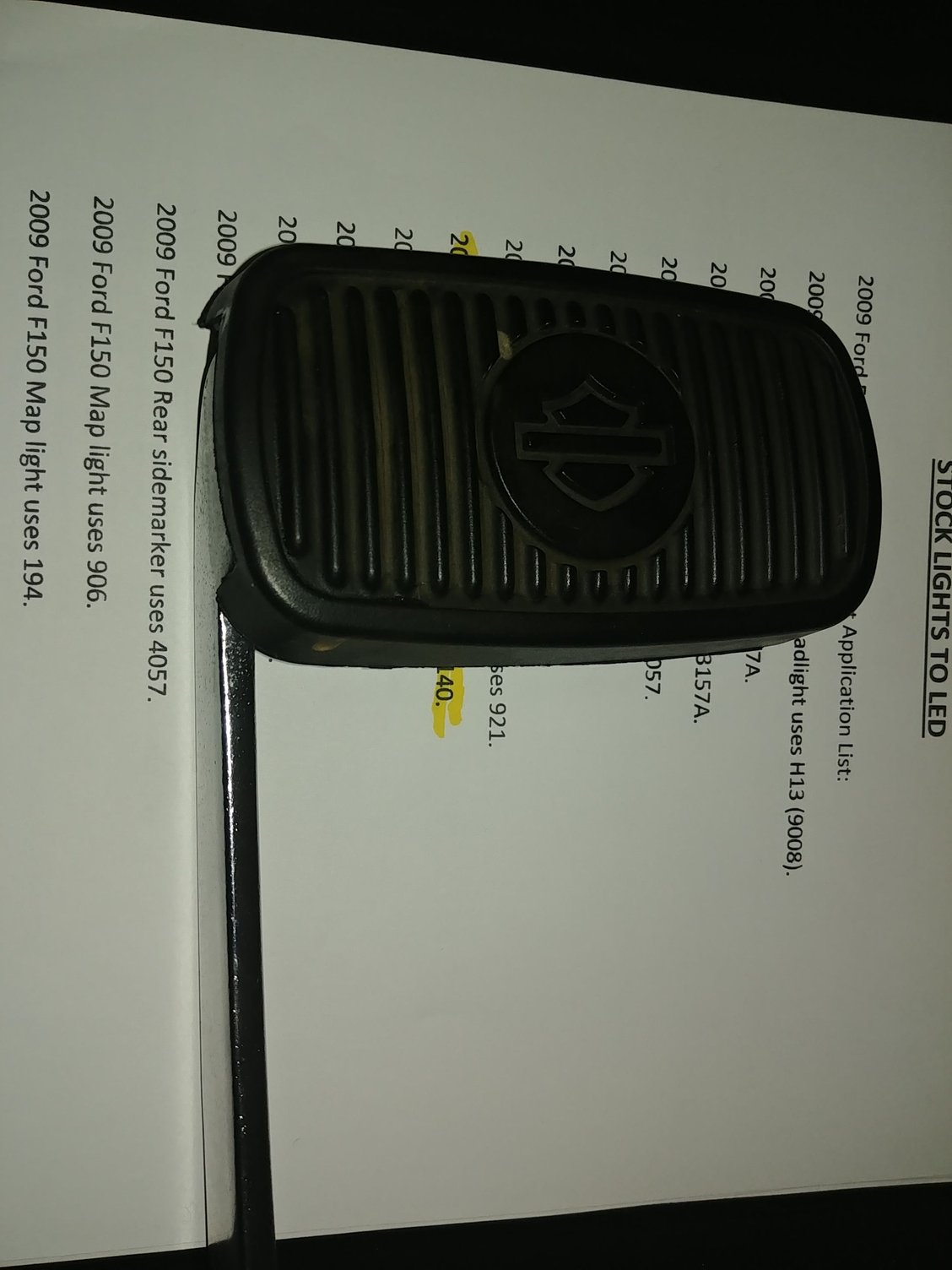

Installed an E-Z Brake today I thought I was going to have trouble getting to the cotter pin on the brake cylinder,but I can not get the rubber off the brake arm.Whats the trick besides cutting it off I
want to use it till my new one comes,I tried soap.Thank's

Wd 40 and a screwdriver wedged between rubber and chrome?

Hairdryer to warm and soften rubber. It will stretch easier. Takes more force than you think,

My Fat Boy has a V notch in the metal pedal, and a V protrusion inside the rubber pad to stop it sliding off. Use 2 large screwdrivers and a lot of force.

spent to much time on it I ordered a new one,just hope it's not that hard putting it on.
thanks to everyone for your help..

It's a bitch to get off. It's been a year or so since I took my OEM off, and my memory is fading, but I think I ended up cutting it off (had the replacement Kuryakyn extended in hand).
