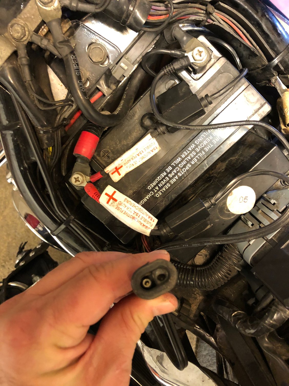

So looking at the battery it appears to have 3 cables from positive and negative ?? See this photo. Two of them have the male female connector as shown ?? Any ideas why there may be two them ?
