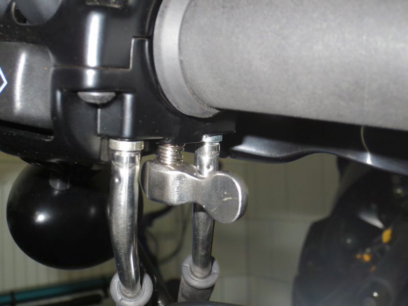

If you go that route, I made this myself in RVS for my Iron and Forty Eight. It works perfect en hold the throtle just enough to keep your speed, in case of an emergency you can move the
the throtle forword without lossen the lever. The lever can be adjusted with the screw so it hold the throtle just in place no more no less.
