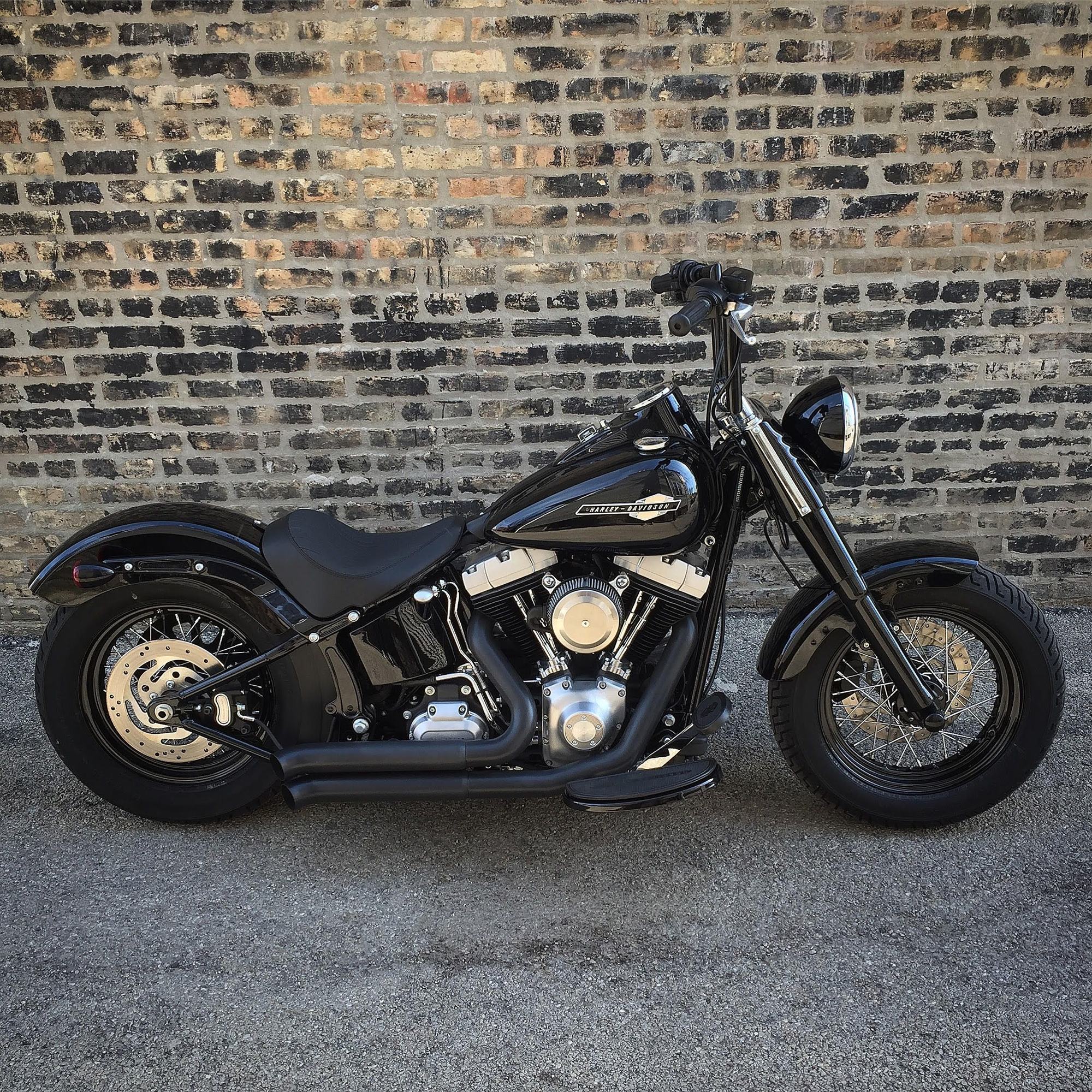

Hey guys,
Proud owner of a 2017 Softail Slim as seen below. Stage 2 kit with big cams, lowered 2" front and back, etc..
Over the winter I had RideWright make me up a 21x3.5 front wheel to match the stock HD rear wheel. Wheel came out great, now I need a tire and fender for it. I want to stick the fattest front tire I can on this thing to keep the "chunky" look the slim has from the factory. After looking around it looks as the biggest 21" tire is a 130/70/21.
I had heard back in the day if you run a 130 tire you have to order a fender intended for a 23" wheel because the aspect ratio of a 130/21 is the same as a tire used on a 23" wheel ?
Has anyone done something like this on their softail (or other HD) ?
As always any and all help is greatly appreciated...

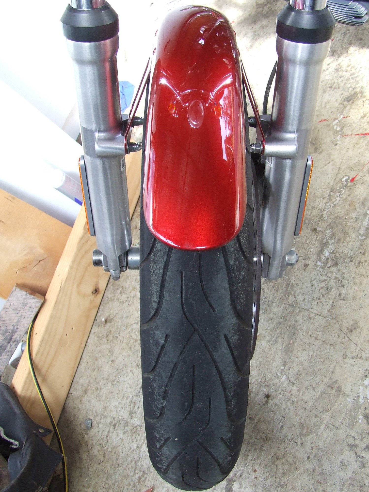

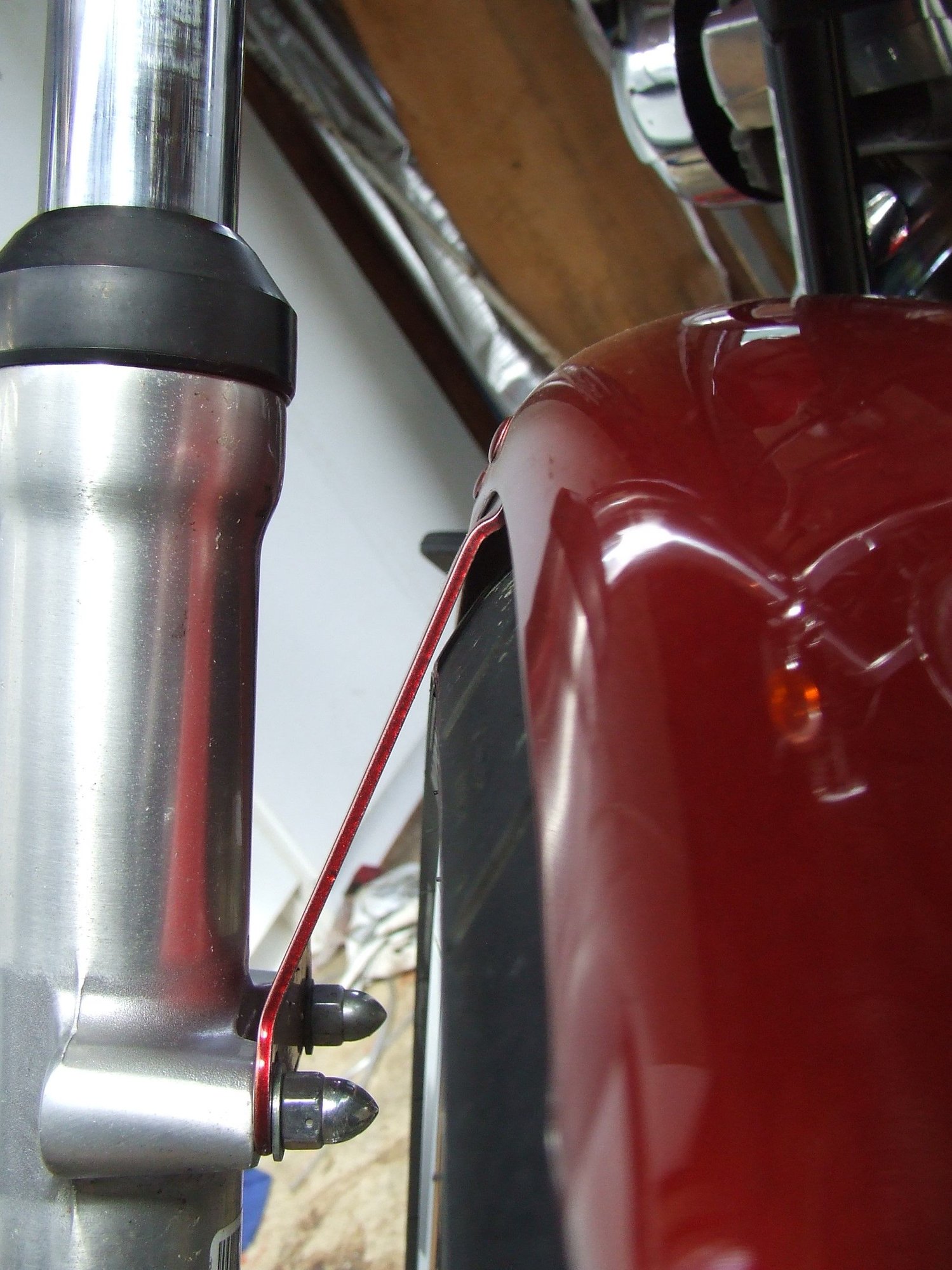

Yes, I have put a 21x3.5 rim on my Softail Standard FXST.
I run a 120 wide tire on it and much prefer that to the original 90 wide tyre.
I modified my fender by elongating the mounting holes so that it could be raised a little bit to clear the wider tire.
Just could not find a suitable alternate fender anywhere.
It only just fits, the gap in the picture is about 5mm from tire to fender support arm. Have done lots of miles like this and it has never rubbed.
From above the tire is wider than the fender however that has not been an issue either. I guess in the wet water flings off the middle of the tire.
A breakout fender is the right size, but alas it has different mounting holes for the FXST, not sure about your bike though it may be worth checking.

Can you post some side shots of your bike please ?
Old Mar 6, 2020 | 03:26 PM
Alexander Pearce's Avatar
Alexander Pearce
Joined: Dec 2019
Posts: 115
Likes: 66
From: Tasmania
