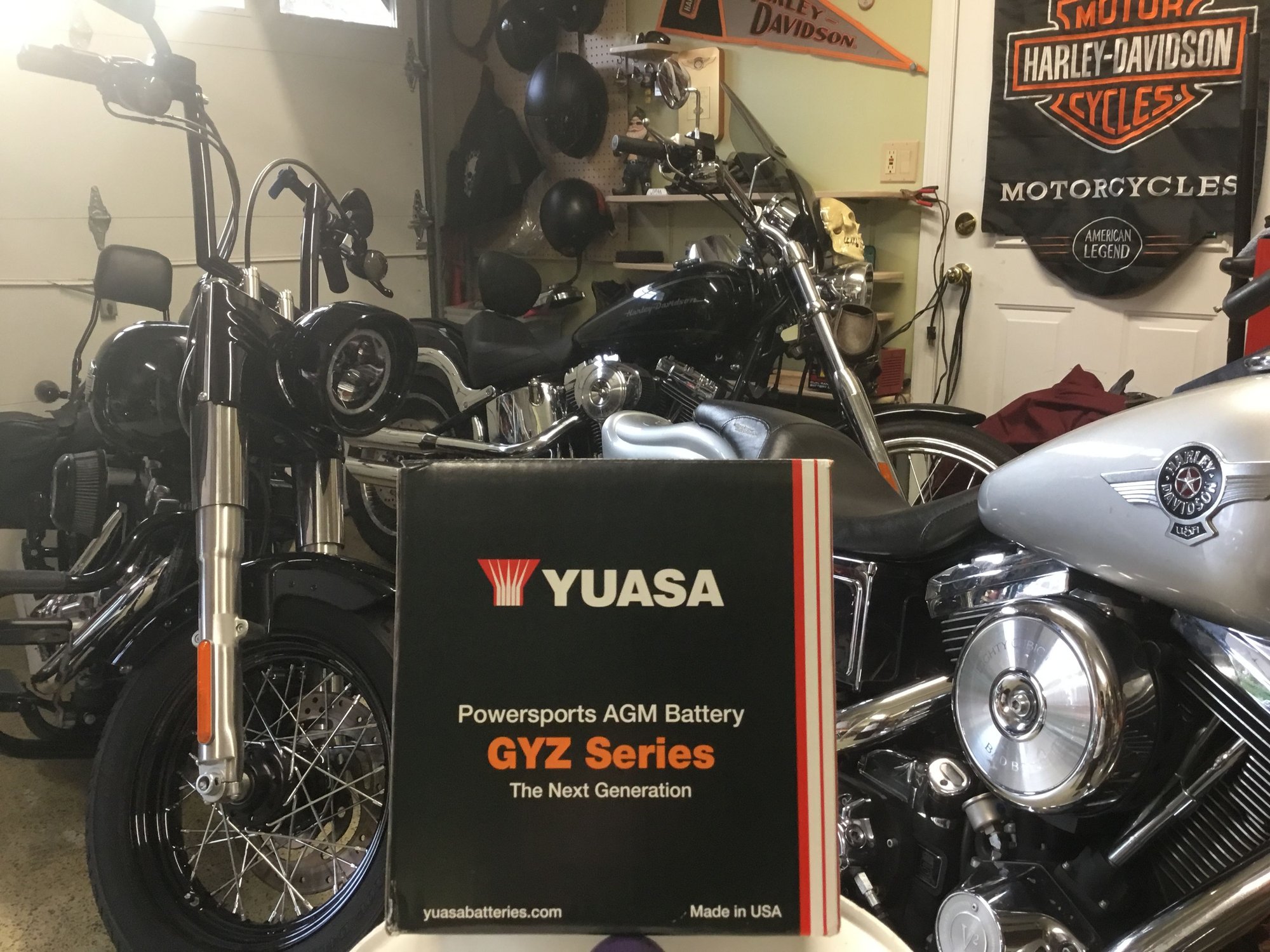

Old Mar 24, 2020 | 05:38 PM
Iron lHorse's Avatar
Iron lHorse
Joined: Jan 2010
Posts: 7,395
Likes: 3,359
From: usa
Made in the USA and got it for $115
