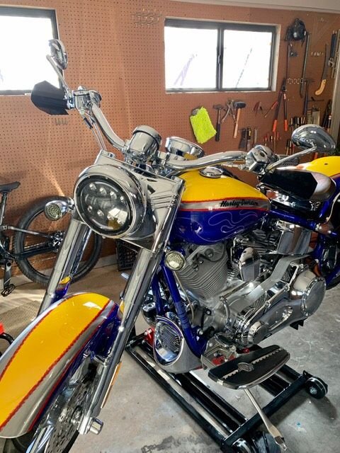

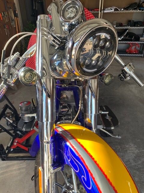

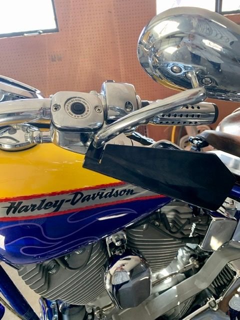

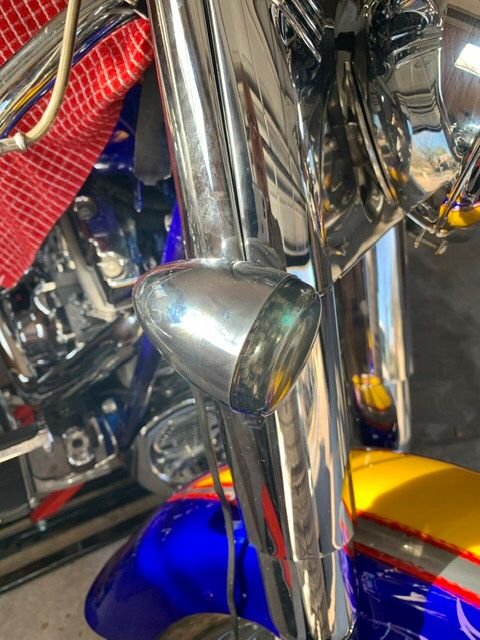

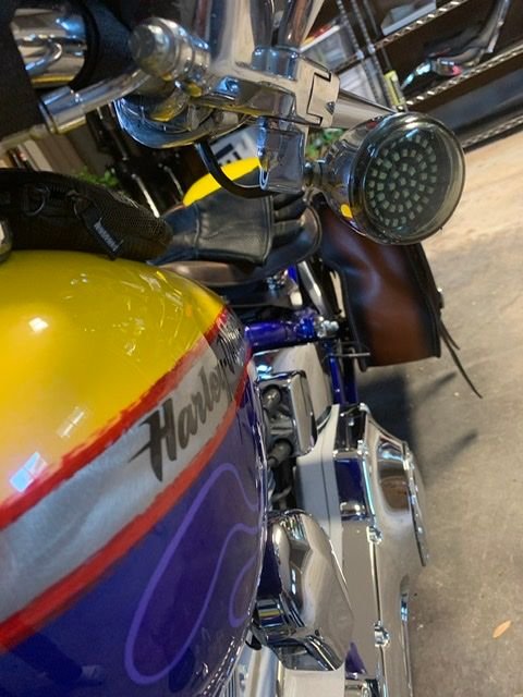

Okay. Got her done. I Like the turns much better on the forks. Also, got the wind guards installed. Took a little adjustment, but I think they will perform exactly as needed, and simple to remove in the spring.
