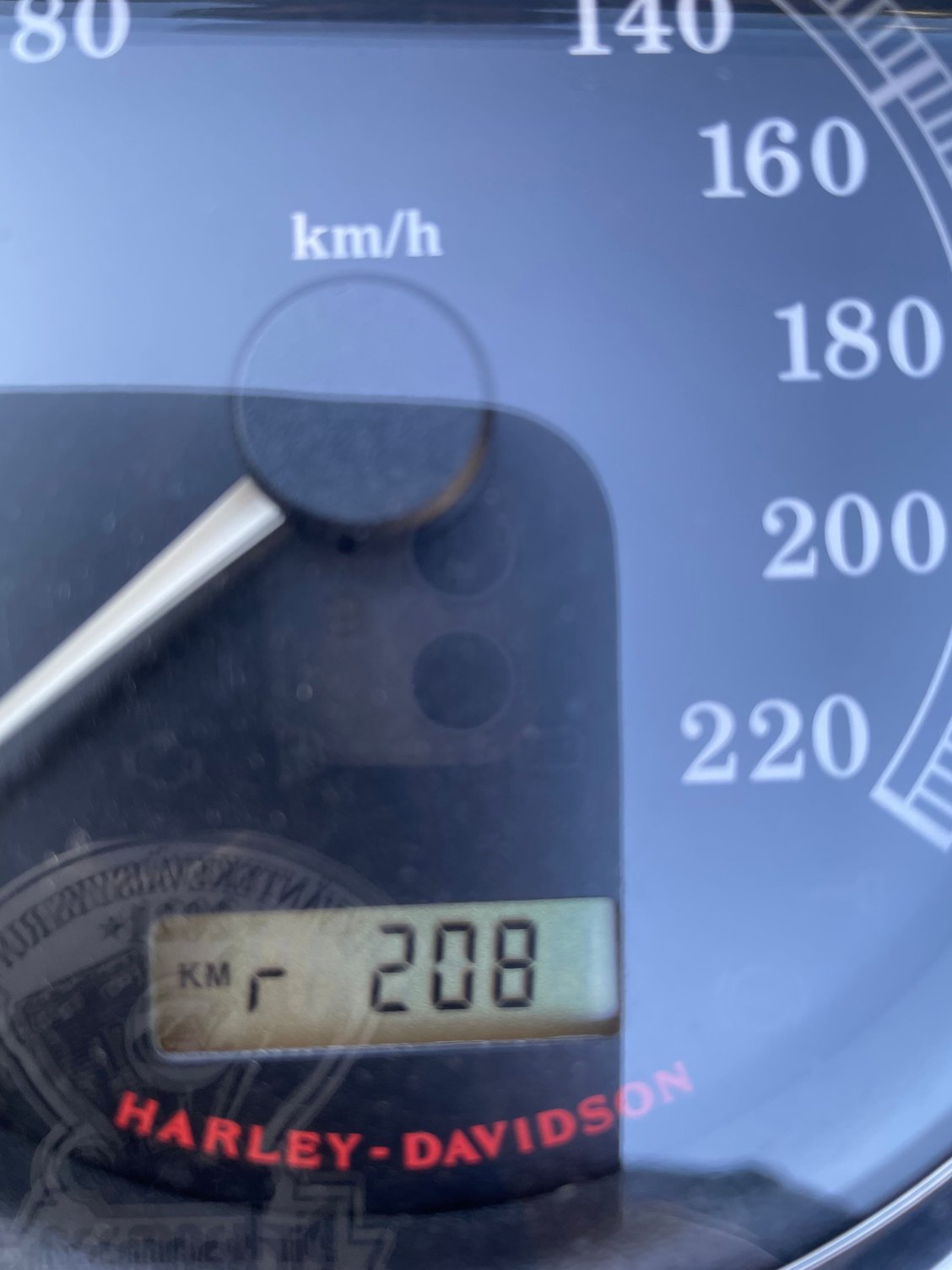

Novice help. What does this mean, 2009 nite
What does this mean? No manual at hand

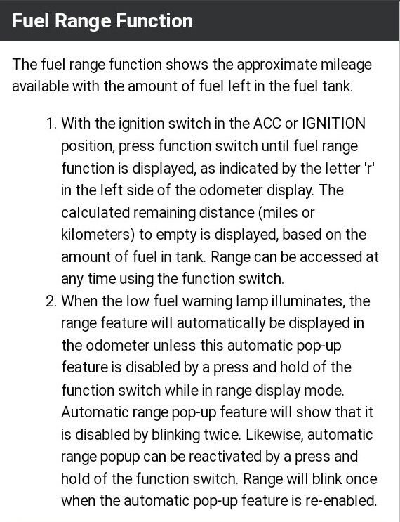

May be a stupid question but what of the ECM has been changed?

I would suspect that as long as the new ECM tables relating to mileage are set up for that particular bike, the range number should be as accurate as before the ECM swap...
I have found the range number to be close at times, and sometimes it's off by a good bit.... It can change rapidly if I start to play with the throttle...
It's just a guide anyways, nothing I would consider a concrete number...

I think what he is asking is = If the ECM is changed with a new speedo or the speed that matched that ECM [ form another bike ], wouldn't that be a way to show incorrect [ lower ]milage?

Yes, that's pretty much what I was asking. However, that might be a very expensive way to lower the displayed mileage. I have no idea what a HD ECM cost.

Interesting question.... my bikes have the mileage in the speedo on two, and the other has a BCM... so not sure what part the speedo has on changing the ECM...
Prior to the BCM, there were a series of speedos (forget the years) where the speedo got the mileage from the ECM via a temporary cable connection...... Then you would install the speedo and drive for 25 miles. After 25 miles, they were permanently married.
I've never read about going the other way... changing the ECM and matching it to current mileage... or if it even needs that...
Someone will know/chime in with the procedure...
