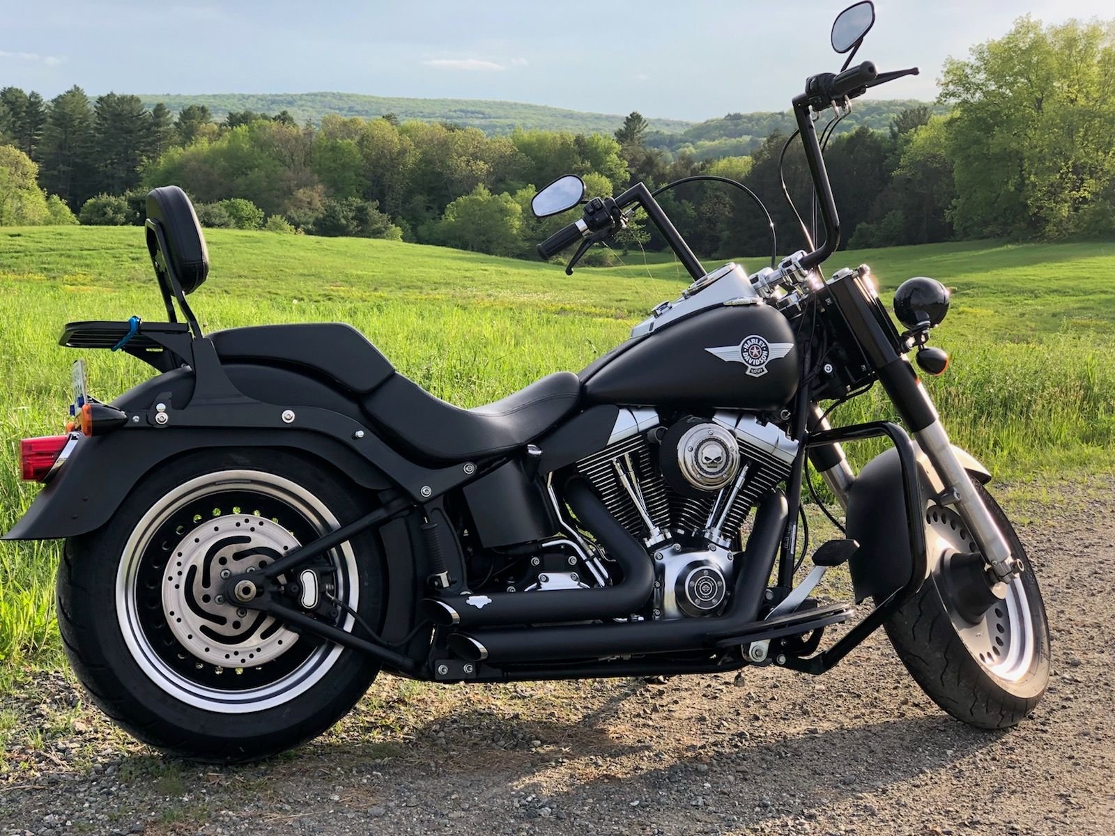

Originally Posted by glidein wide
Bike doesn't have a carb, when he bought it 2 years ago, he would ride about 180/190 miles before fill-up, now he's under quarter tank at 120...
The fact that it is a sudden drop in MPGs is the key...
Assuming all else is equal, ie: riding style, riding locations, and the bike is well maintained.... the sudden drop in MPG suggests an over fueling issue. Also, backfiring can be caused from over fueling
Has he looked at the plugs?
There are several things that can break/malfunction and cause an over fueling issue. It could be one of the sensors that monitor the airflow that tells the ECM to supply the proper fuel, the fuel injectors, or even the O2 sensors.
Usually it is a sensor that needs to be replaced/cleaned like the MAP sensor, IAC sensor, etc.. or the wiring to a sensor has been pinched, chafed, or broken.
He needs to start investigating the various sensors, their wiring , and then ultimately some hardware like the fuel injectors and/or O2 sensors to find what is causing the over fueling into his bike...
Good luck with the fix
