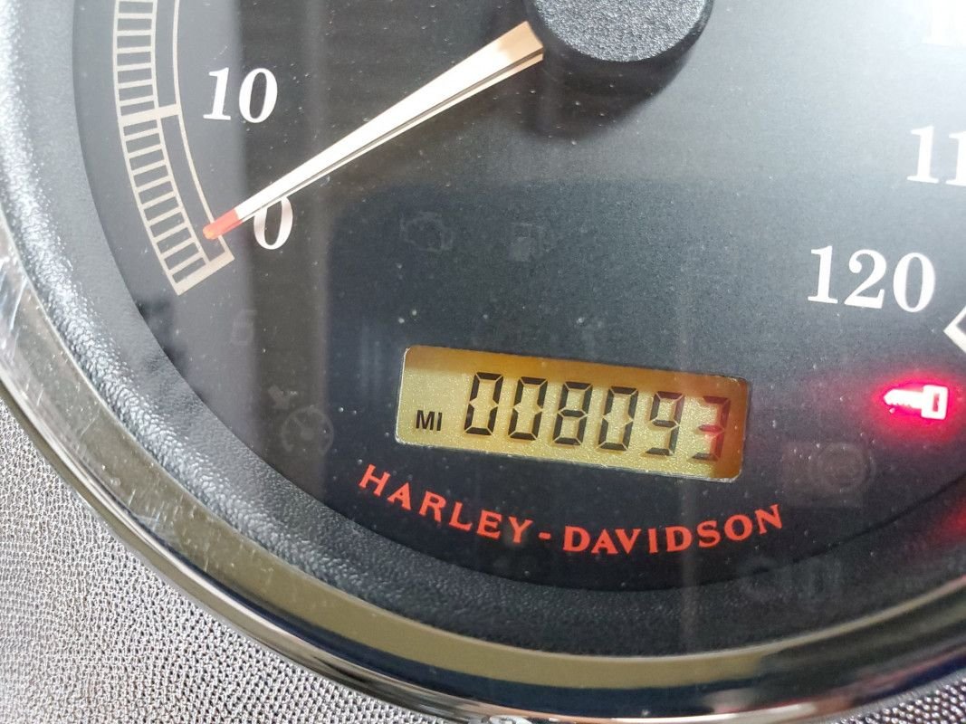

AFAIK the bike does not have security and did not come with a key fob, the red key on the speedo face lights up for a few seconds at start but goes away.

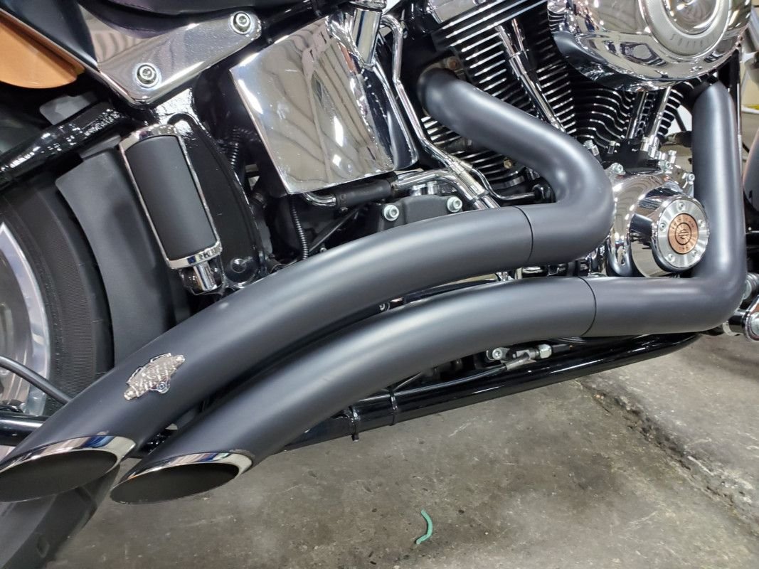

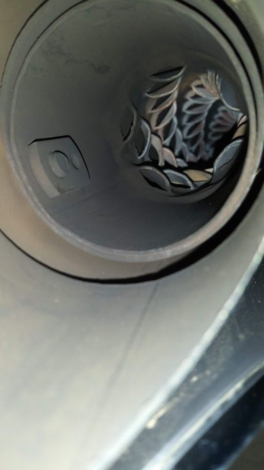

Came with V&H big radius 2 into 2 pipes, but I am not sure what baffles are in them. Seems quiet to me, after having SE 2 slip-ons with Big City Thunder baffles on my 04 FXSTI TC88, any easy way to tell what is in the pipes?

I may have it figured out. I pulled trouble codes and for "S" I got no errors and p/n 68921-07 which is a regular turn signal module. So someone pulled the HFSM or it was never installed and I got the antenna as a bonus. Debating getting one for the insurance saving or forgetting about it after reading the problems they can cause.
Also my V&H BR have the stock baffles I believe.
