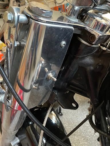

All Evo era Heritage Softail Classics (FLSTC) came with aux lights.
The switch is on the rear of the left side fork cover.

Thanks! That's where it was. I just noticed it when I sat on the bike after working on the carb and petcock repairs today.
