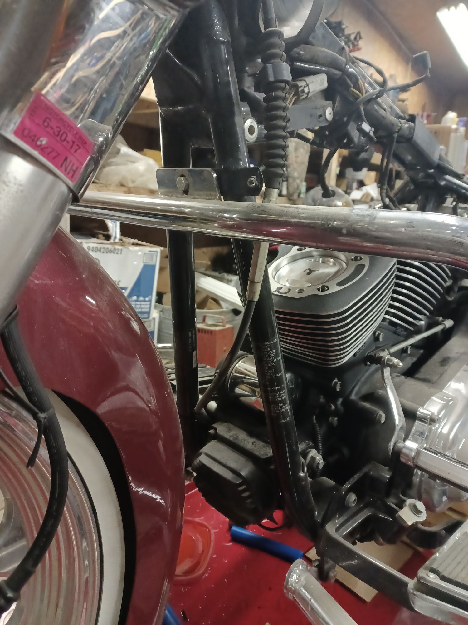

Default bent Bar Mount
Originally Posted by brakeless
Definitely bent. I'd give a few whacks. Or maybe put a block behind it and use a big C Clamp to see if you can slowly bend it back. It would have to been hit hard with a previous "Engine Guard" on there in order to bend like that.
I smacked mine with a dead blow with a 5lb hammer behind it.
Didnt even scratch the paint.
crash bar Mount.
