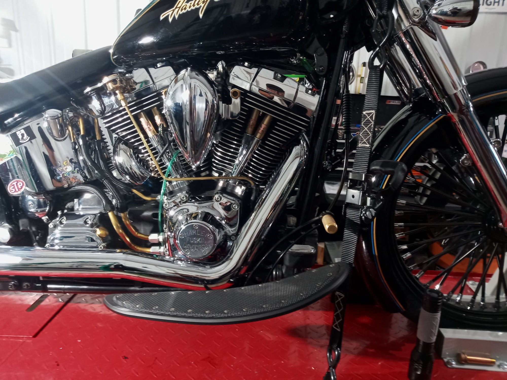

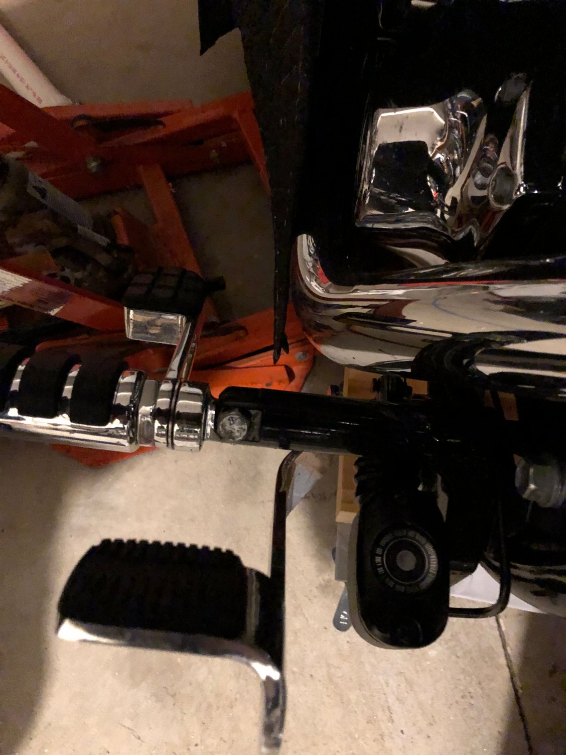

My bike already had boards so my banana boards bolted right on. I think all you may need is board mounts on your bike frame, it looks very similar to my 06 Deluxe..
The most comfortable ride I have ever had. Even my seat feels better since I can move my feet far forward or behind me. Love the banana boards. You can see in photo how far you can move.

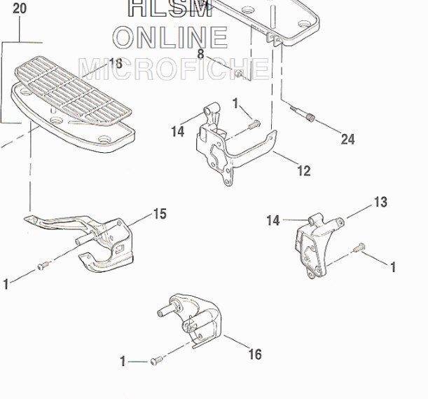

They look like these. You need parts 14 and 15. You can look up your bike here......

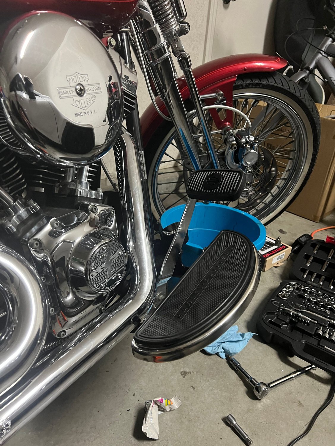

Brackets from 2000-2006 should bolt right up. 2007-2017 will work too but the kickstand changed so you’d need to swap that out as well. I put floorboards with the newer kickstand from an ‘08 Heritage on my ‘04 Springer and it bolted right up. The only thing I did was dremel the back arm on the right side bracket a little because it was right against my exhaust. It probably didn’t need it but I know it would’ve bugged me if I didn’t do it.
