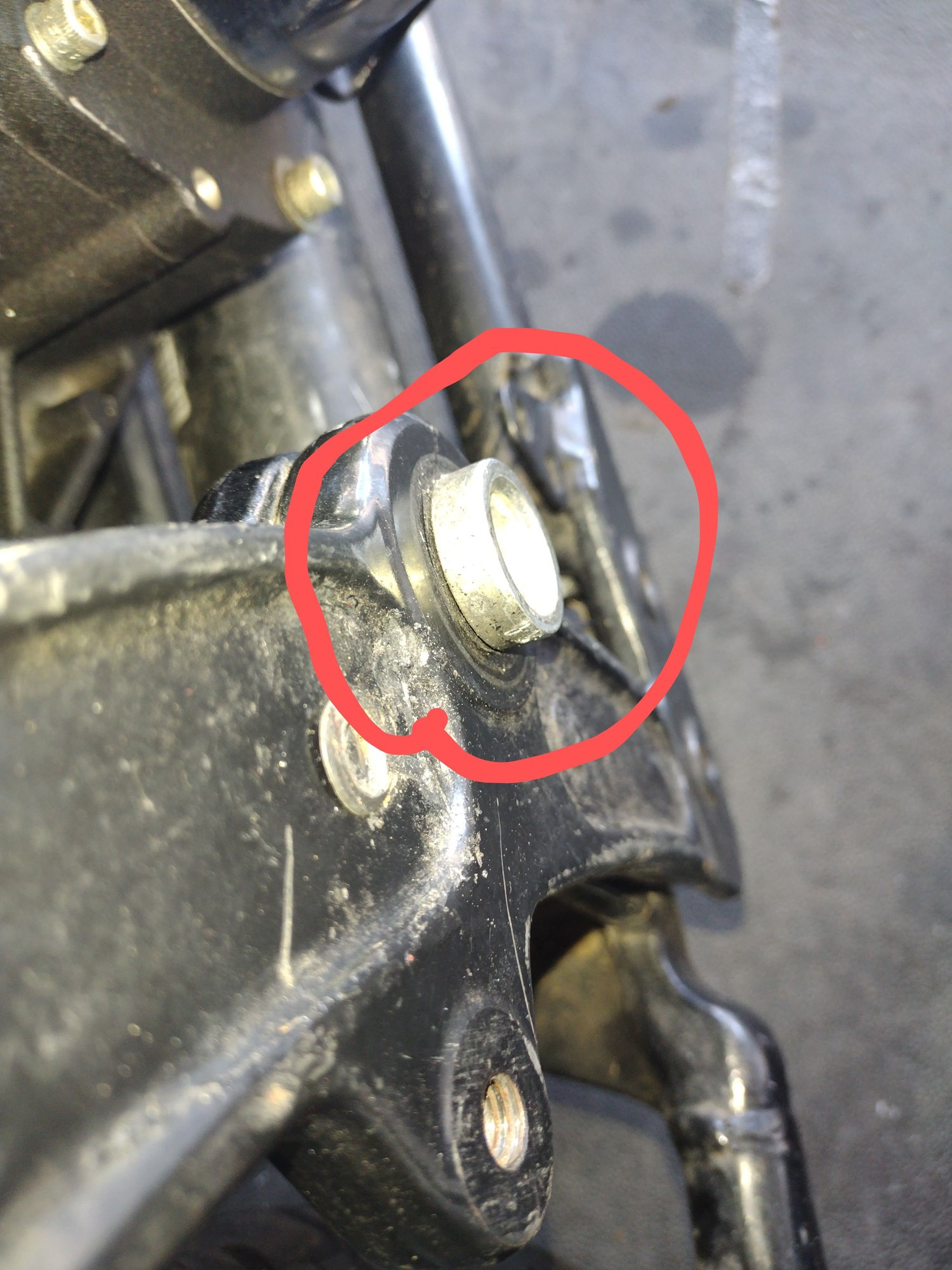

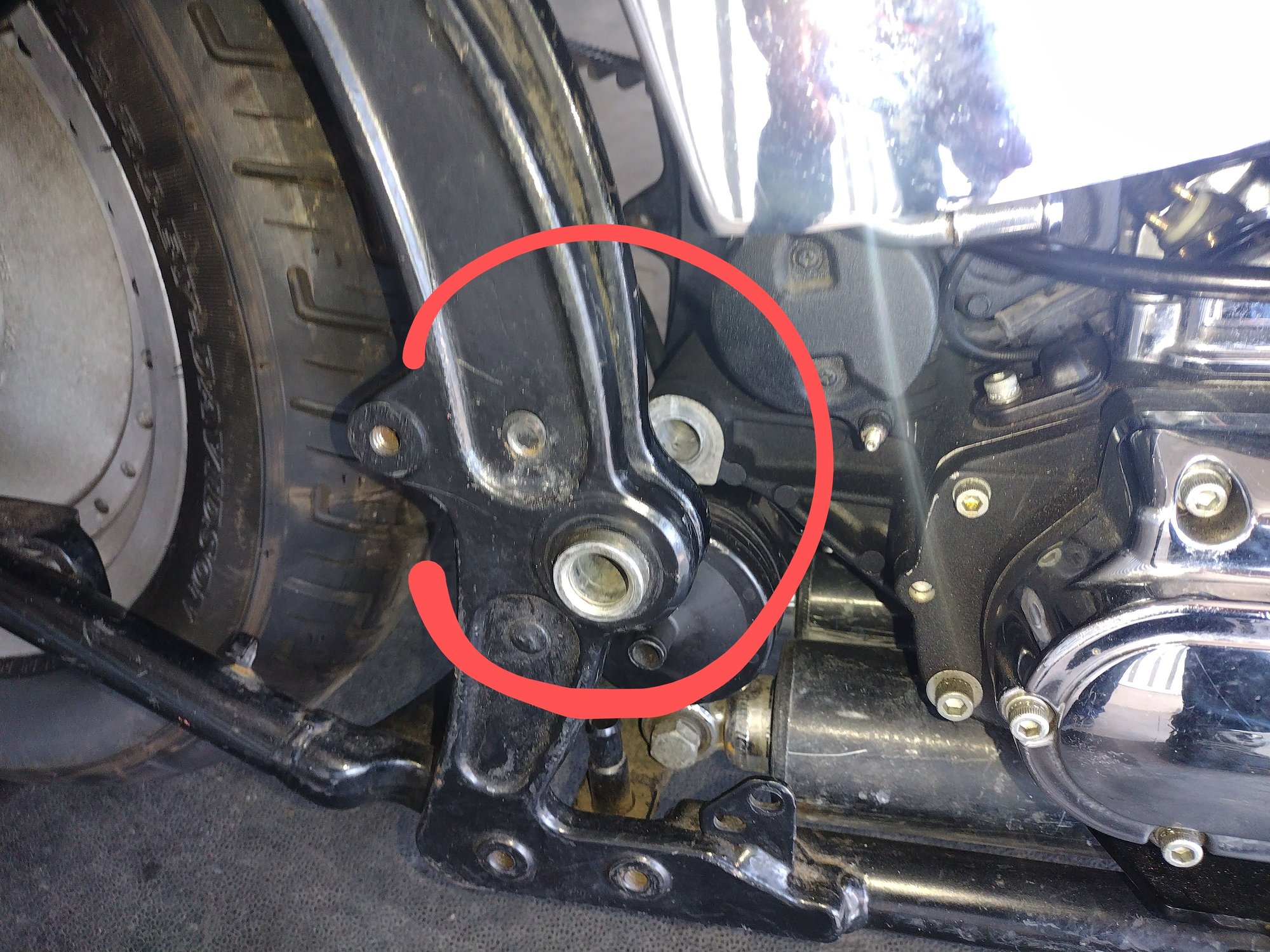

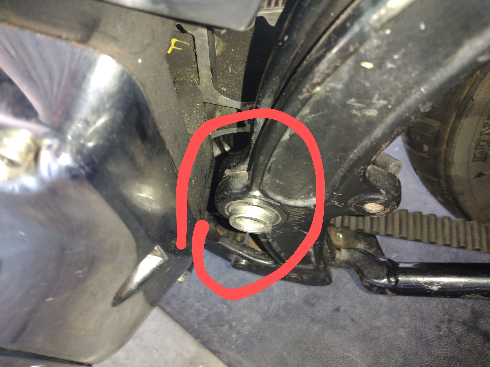

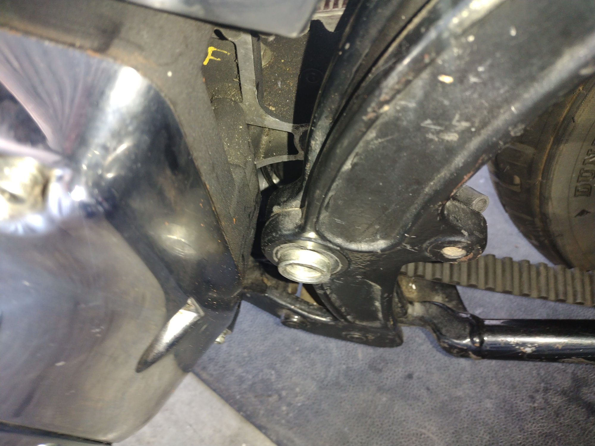

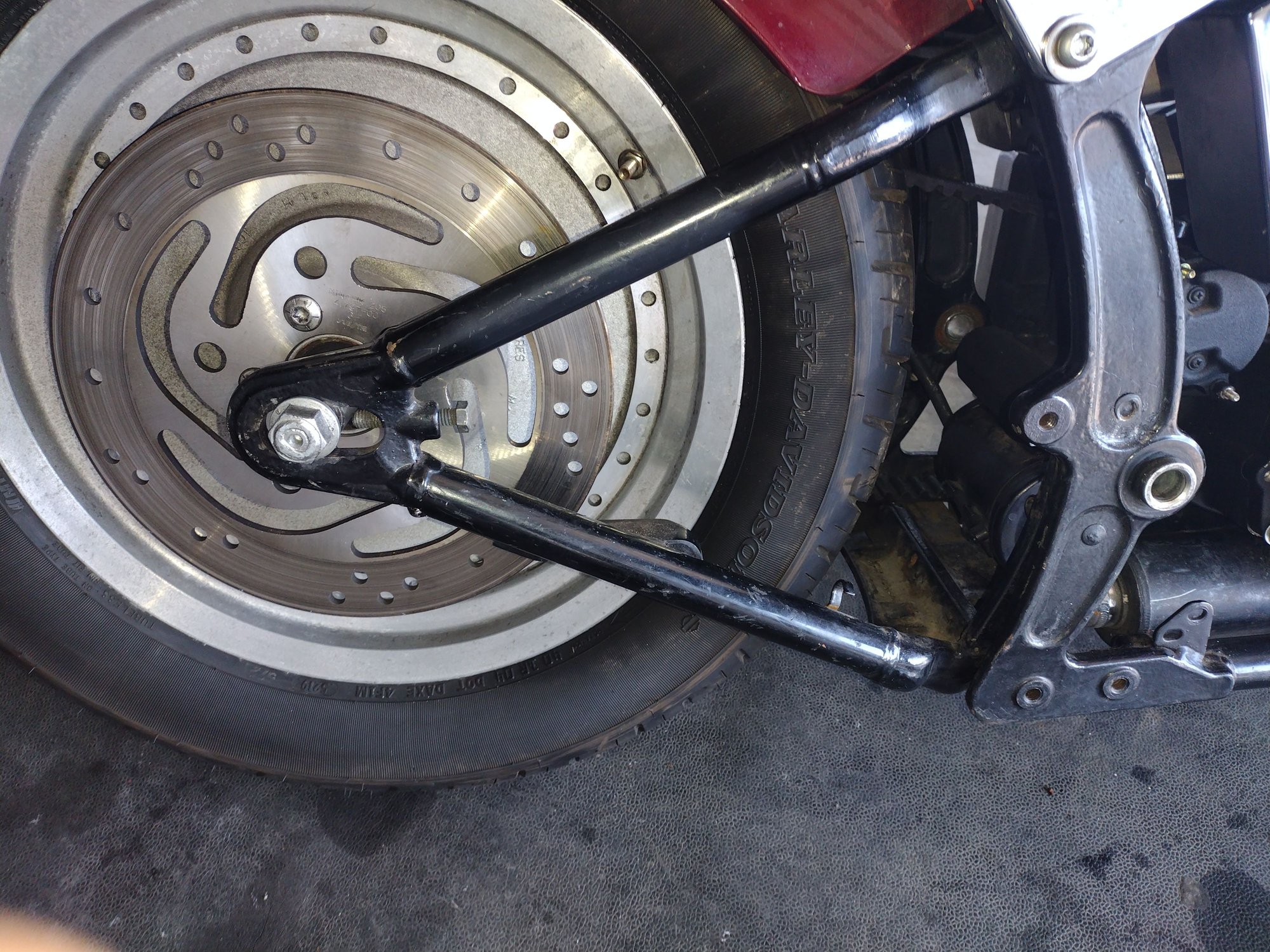

Swing arm issue I am building a 2001 Harley Davidson heritage classic and am having issues with getting swing arm as well as rear axle bolts that fit I've bought 3 different bolts and none have been long enough to use they have been 13 and 13 1/4 inch the issue I'm having with the swing arm bolt is I have inserts that stick out on the outside of my swing arm about a half inch each making the bolt to short does anyone know what bolt I need to get to fix this issue my rear axle bolt has the same issue of not being long enough please help

Posted this on your other post too. Are you sure the bushings are not in backwards? I can see the spacer pointing towards the swingarm, not away like they are installed. Just doesn't look right at all.

Something assembled wrong or aftermarket bushings in that swingarm.Bolt head and nut should sit flush.
Need more info
Was it ever together?
As far as rear axle, it will pull in a bit when tightening nut, but shouldn't be any issues getting nut engaged unless swingarm is bent outwards
You sure you have correct spacers there

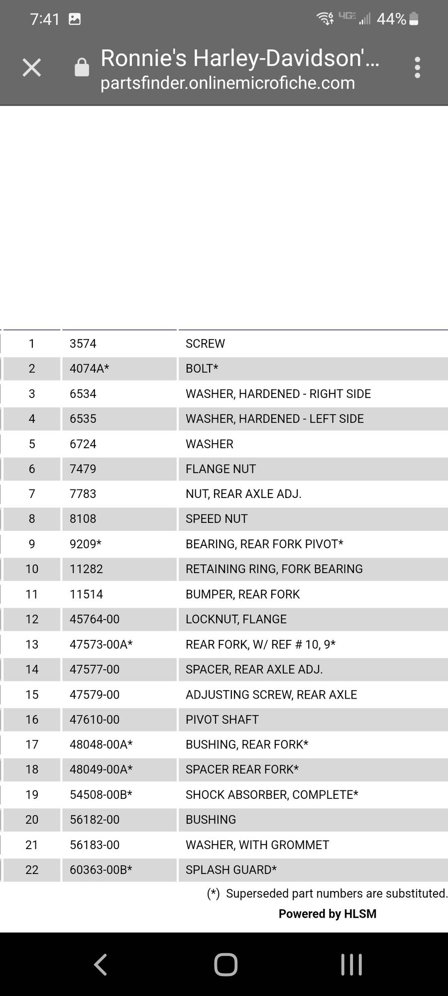

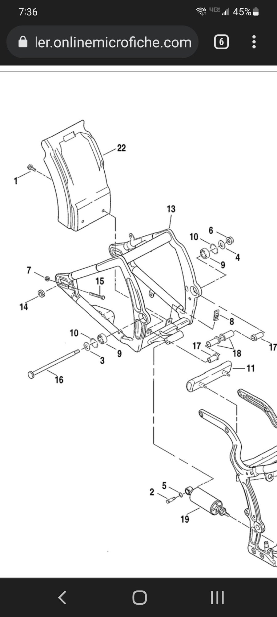

https://partsfinder.onlinemicrofiche...HOCK%20ASORBER
