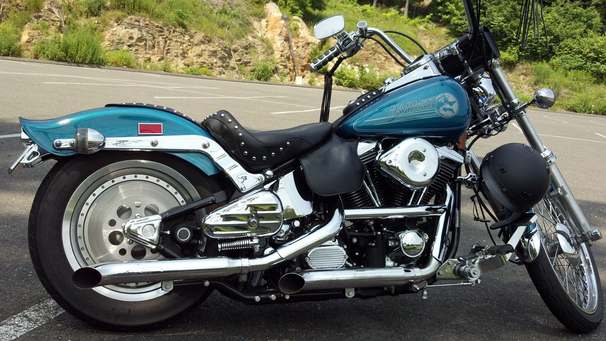

I don't have any "before" pictures. But I was able to look right over the tire between the fender before.
I went from this, and this is lowered with the lowering shock extensions. It was a terrible ride
To this

Looks great, how much was it lowered before the air ride?
