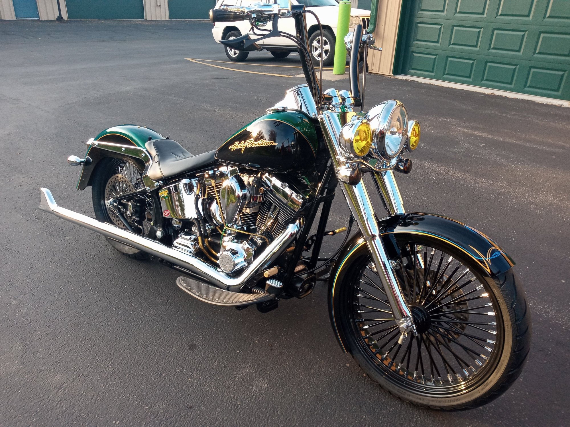

I lowered my Deluxe 2" in the rear and put an 18" in the rear and a 21" in front. No handling problems at all on my bike. From what I understand the OEM fender will fit no problem but I changed my front fender to a wrapped one and lowered it so I didn't have the dirt bike look.
Very nice bike.
How much did you lower the front with the 21?

Absolutely Zero.
Absolutely Zero.
Ok, so in the above picture that is 2" drop in the back and stock height in the front?
That is correct. Stock height with a 21" wheel.
